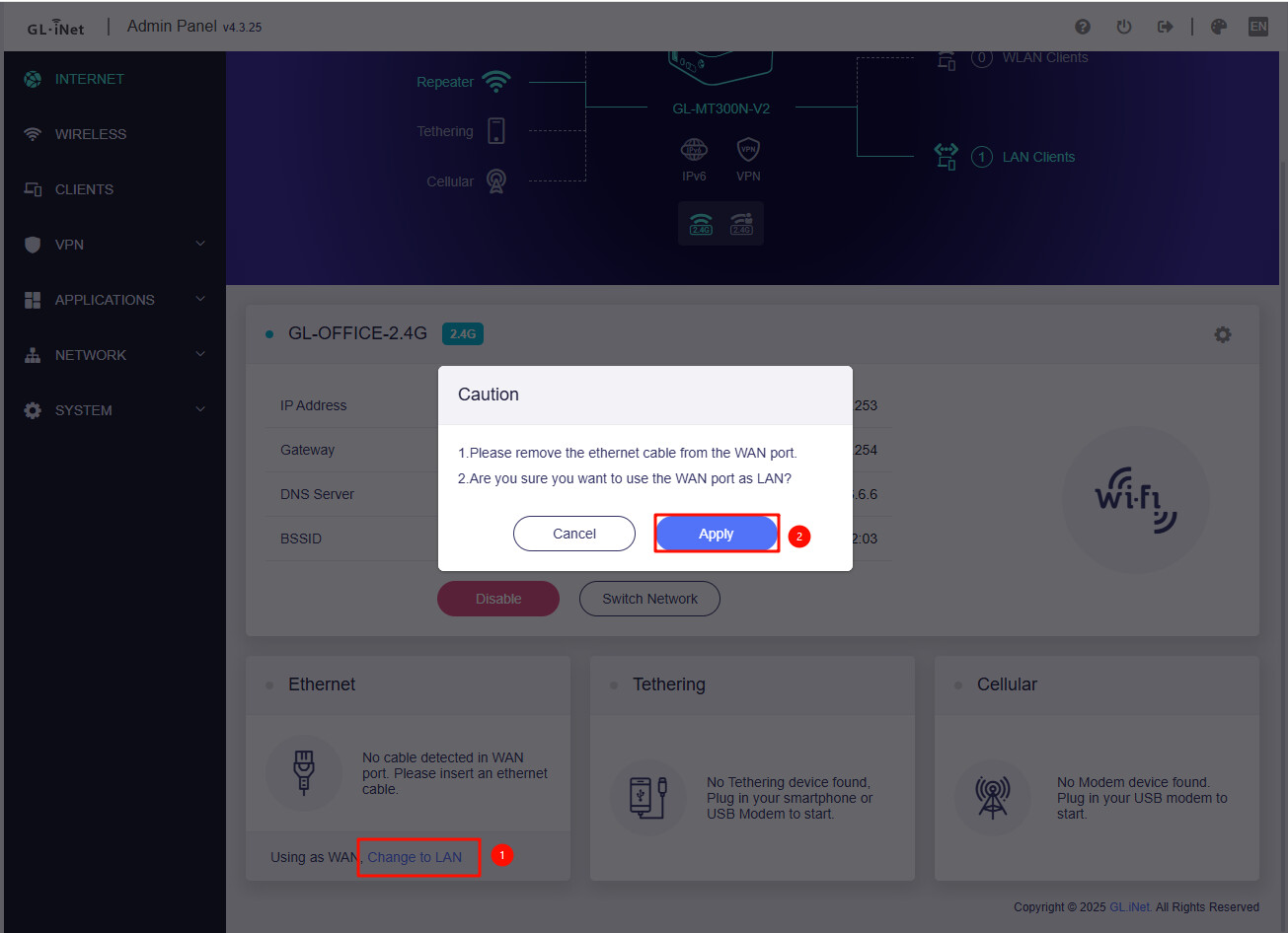

It sounds like you’d like to connect your ThinkCentre M910 and KiwiSDR to the Mango’s LAN network. Are we understand correctly?
If so, please change the Mango’s WAN port to LAN port as shown in the picture below:
If you don’t see this option, your Mango may be running an older firmware version.
Please upgrade to the latest stable firmware:
Download Mango Firmware
Upgrade instructions:
