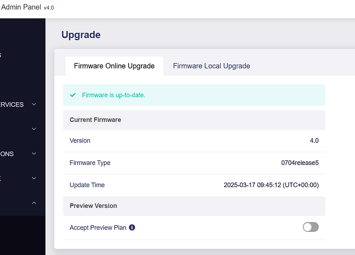

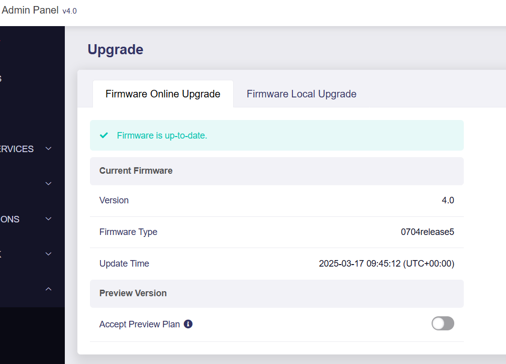

updated uboot on XE6000 but still dont get the upgrade button on admin panel.
still shows V4? but firmware type 0704? so i already have 4.7.4?
did a manual upgrade with the 4.7.4 file.
And i still see same firmware details here.
how was I already on 4.7.4 before today?
