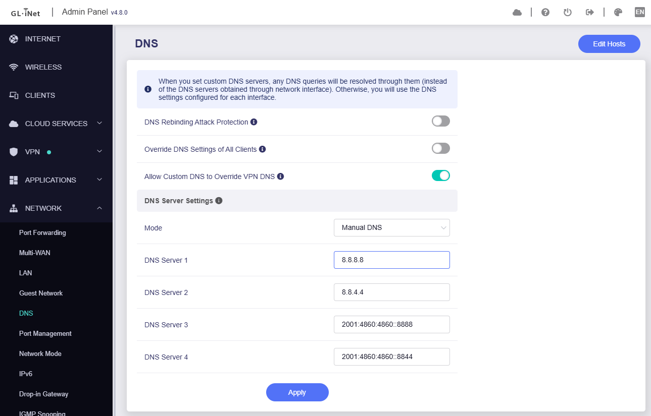

Ddns not resolving. How can i fix this ? It used to work before
Mon Aug 25 16:22:32 2025 daemon.notice netifd: Interface 'wgclient' is now down
Mon Aug 25 16:22:32 2025 daemon.notice netifd: Interface 'wgclient' is setting up now
Mon Aug 25 16:22:32 2025 daemon.notice netifd: wgclient (28512): Name does not resolve: `******.glddns.com:51820'
Mon Aug 25 16:22:32 2025 daemon.notice netifd: wgclient (28512): Configuration parsing error
Do you see your IP for that GL DDNS when using?:
Try manually modifying the router DNS to 1.1.1.1 or 8.8.8.8.
And how about ping [your GL DDNS domain]?
