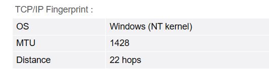

So far browserleaks.com is the only place that I have seen my Wireguard tunnel be "identified"
Do you think that changing the MTU back to 1500 on the outgoing WAN interface of the exit Flint could fix this maybe?

It is the MTU of the entire path that is the problem. Basically the MTU of the path is the lowest of all different the MTU's in the path.
Setting the MTU on the WAN will not help, because the MTU in the wireguard connection will be lower (like 1420), because the remaining bits are overhead for wireguard. You likely cannot get the MTU of the wireguard link to be 1500, because then it likely exceeds the MTU of other bits in the route as those would not handle the MTU of 1500+overhead needed for that.

Setting the FlintB to 1500 will not do anything, because WG tunnel has MTU 1420, which is lower. The highest MTU of that path will therefore be still 1420. Therefore any packets bigger than 1420 will be be able to take that route and therefore not reach that FlintB WAN.
It you were the set the WG-tunnel to MTU 1500, then something on the route between FlintA and FlintB will make packets disappear, because there will likely be something between FlintA and FlintB that will not allow >1500 MTU.
The VPN protocol makes a difference on how well it hides you. I have a GL iNet AR300M that is running OpenWrt 23.05 at a family members home that connects to their 5G home internet router. I run 3 different VPN packages: Wireguard, OpenVPN and SoftEther. Using your test to the same router, using the 3 protocols shows:
https://browserleaks.com/ip
Wireguard using MTU 1280
