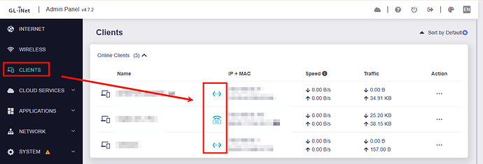

In the router’s Client interface, you can view all wireless clients connected to that router or AP.
Please note the small icon to the left of each IP address — it indicates whether the device is connected via Wi-Fi or Ethernet.
