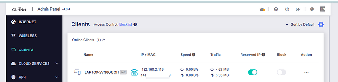

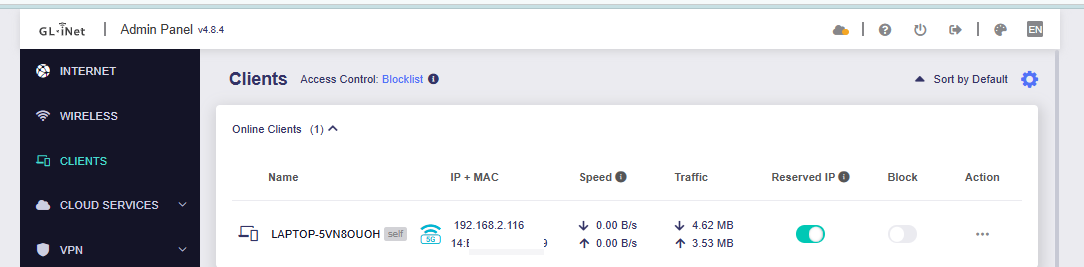

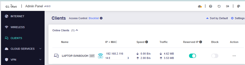

We also tested upgrading a Flint 3 from v4.8.4 to v4.9.0 locally with settings preserved, and the configured Address Reservation remained normally after the upgrade.

Thanks for your testing. I can confirm that the webGUI was reporting the same as your screenshots post upgrade, however after the lease expired, the MAC addresses in question obtained new IP addresses and the web GUI no longer showed the MACs as reserved. As a result, I reserved them in LuCI straight after as I didn’t understand why the two interfaces are not in sync.
I confirm the reservations are in the /etc/config/dhcp currently, but I don’t know whether that’s a result of me adding them manually in LuCI after the GL.inet interface failed to keep them reserved. Me adding them manually in LuCI also resulted in the GL.inet interface showing them as not reserved anymore, but they do work correctly at present.
