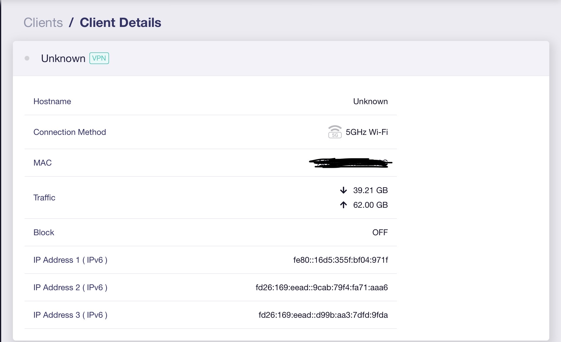

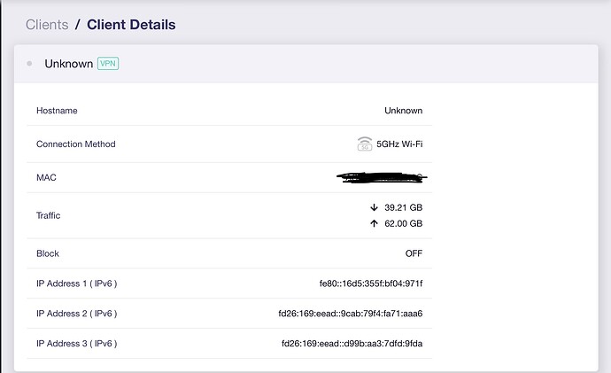

After connecting many devices to my router, there seemed to be an issue with the IPv4 addresses. Occasionally, when a device disconnects from a wireless network (eg. due to connection loss, which is most common), their IPv4 address is removed, leaving only the IPv6 address visible. Sometimes, even the IPv6 address gets wiped as well, leaving only the link-local address when IPv6 is enabled, which essentially does not allow me to reserve an IPv4 address until the device reconnects.

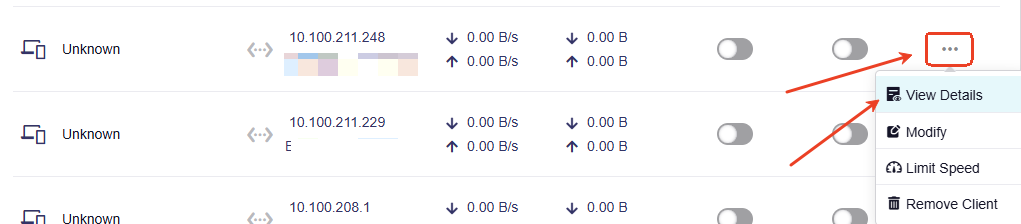

  1. Please check the affected device on the Clients page, then open its detailed information and confirm whether the IPv4 address is still shown there when the main Clients list only displays IPv6.

The affected devices only have IPv6 addresses, either the link-local only or the NAT IPv6.

Thank you for providing the information via private message.
From the results, when the affected client is offline, its IPv4 information is no longer present in the DHCP lease, neighbor table, or current client information. We would like to perform one more test to check what happens when the client changes from Online to Offline.
