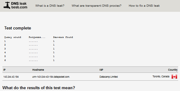

RN I do use MORE SETTINGS | Custom DNS Server | Dnscrypt-Proxy Settings for DNS setup. So when testing my DNS leakage and am getting an unknown server in CA
the very 1st I do is to choose another DNS server like cisco and test again.
Et voila!
2
Quite obviously it’s not my machine(s) who ‘leak’ but the DNS resolvers themself. Only possible change is then to choose another upstream DNS resolver.
