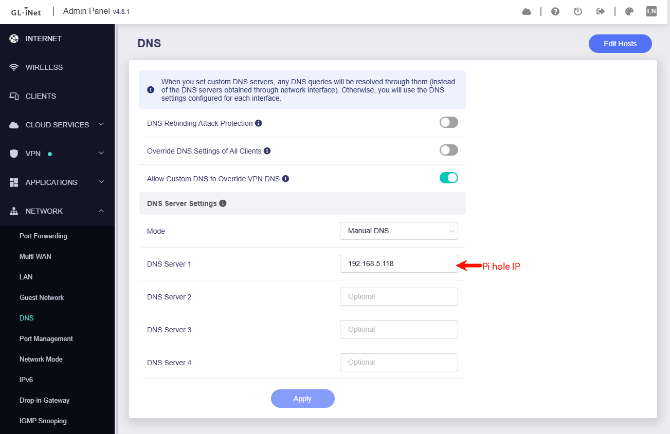

  • The problem is that DNS requests are sent through the VPN’s DNS servers, not Pi-hole — even when the “Allow Custom DNS to Override VPN DNS” toggle is enabled in the GL.iNet interface.

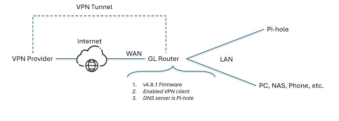

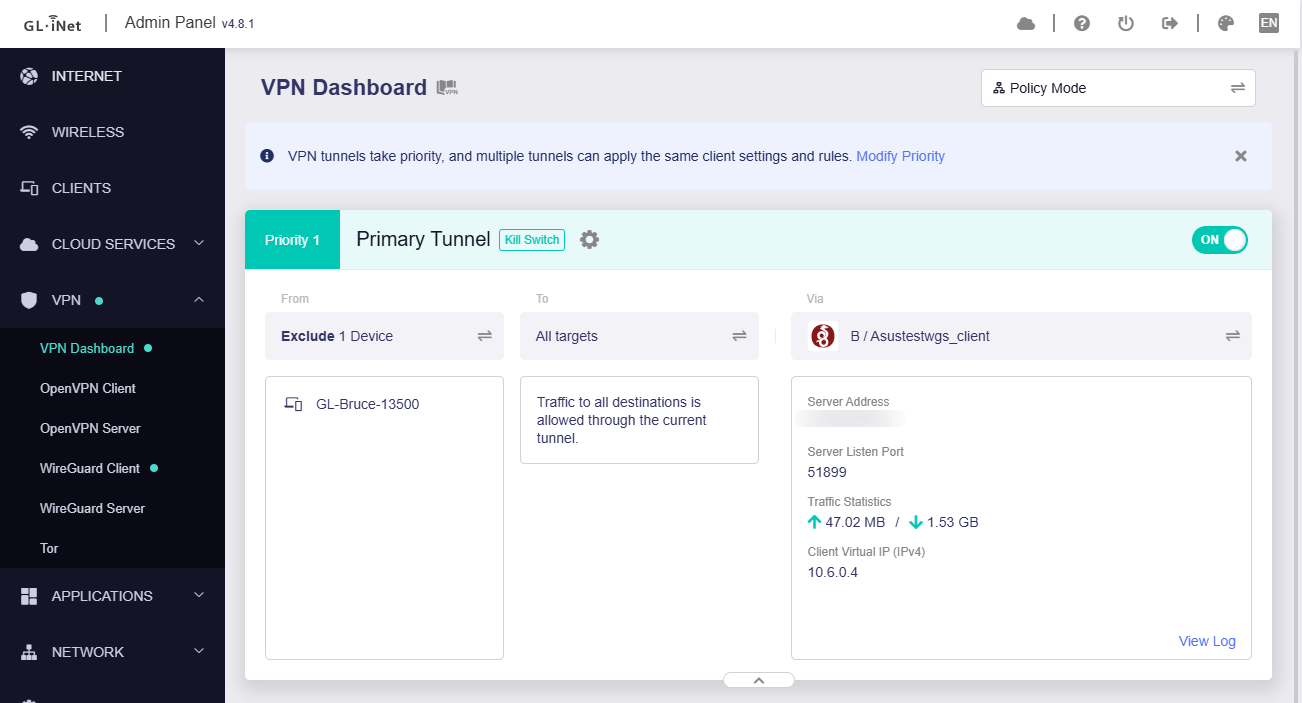

Update, can not reproduce this issue
Do you know if is possible to have a link for the beta 7 of the firmware 4.8.0? Im currently traveling but I don't have with me the file anymore of the beta, so If use the final release 3 of 4.8.0 I'm afraid that I'll get the bug.
Hi, you can upgrade to v4.8.1 latest snapshot:
