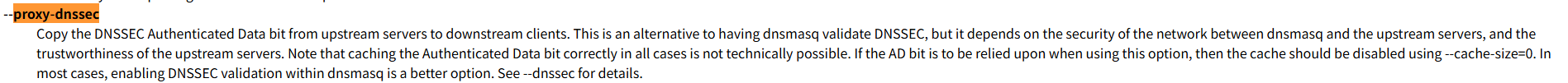

Please refer to the dnsmasq documentation below. If you need dnsmasq to propagate the AD (Authenticated Data) flag, you will need to enable the following option:

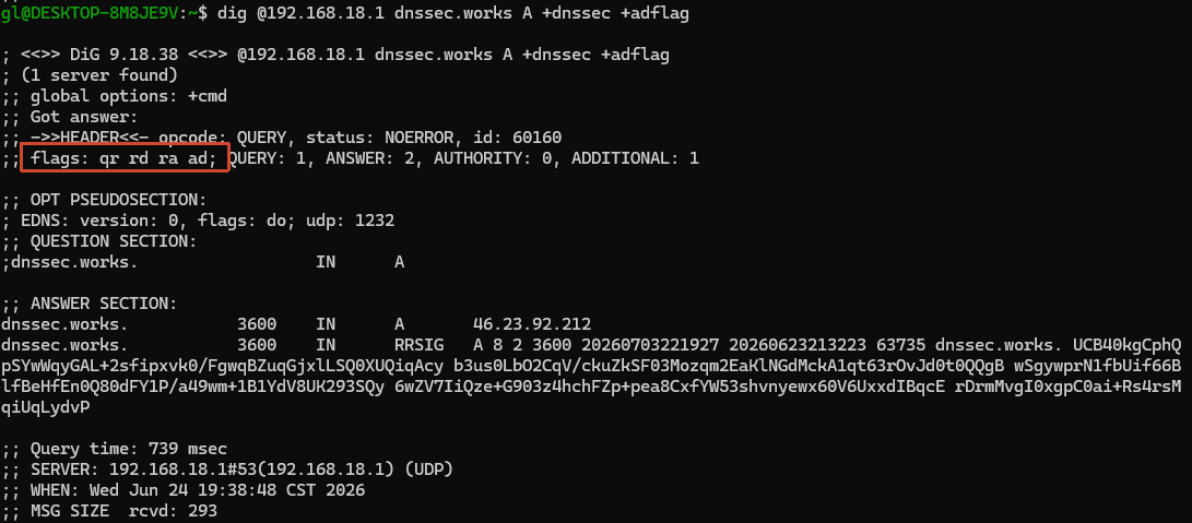

Then you should be able to see AD flags:
