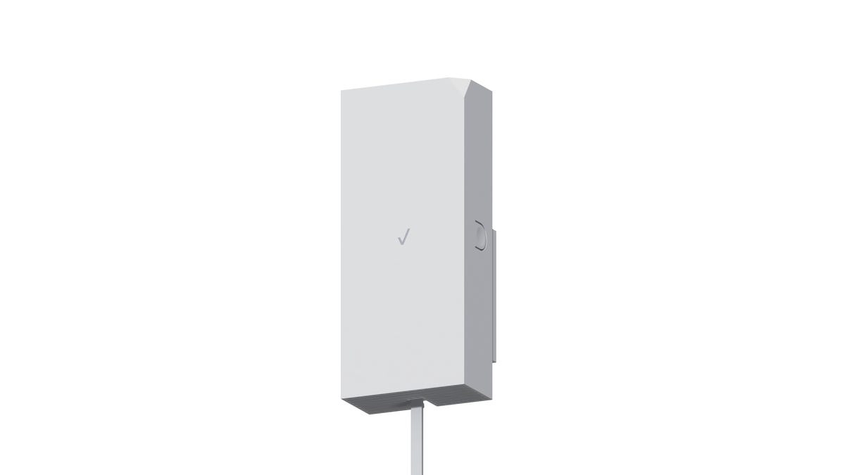

the cellular modem is external, its an AIO reciever that has ethernet out
this is the cellular modem, has an IMEI and everything

SIM is in the antenna, also, i can confirm it does work. i just got the flint. it was plug and play
So we still don't know which device it is. But in the end it works as expected, great.
Congratulations to your upgrade!
the antenna is the cellular modem
the antenna is connected to the router via a PoE injector that comes with the antenna only the antenna is powered this way, the other ethernet jack connects the router to the modem inside the antenna
