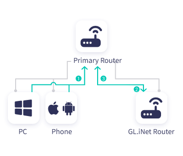

You can refer to the topology below, which illustrates the expected setup when the main router and the GL.iNet router operating in Drop-in Gateway mode use different LAN subnets.
In general, Drop-in Gateway mode is intended for scenarios where:
  • The main router cannot be replaced with a GL.iNet router, and
  • Existing LAN devices cannot easily be migrated to connect directly to the GL.iNet router.
For your use case, it does not appear that Drop-in Gateway mode is necessary.
Could you clarify your requirements and your intended network setup so that we can provide more appropriate recommendations?
