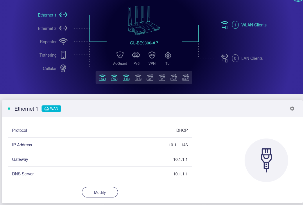

  3. If the point 2 is normal, let us check the Flint3 AP, what does its GL GUI prompt? Is there a triangle yellow prompt of the interface (Ethernet to Flint3 main), for example:
    SSH into it, check ping www.google.com and ping 8.8.8.8

Has no errors or warning at all.
