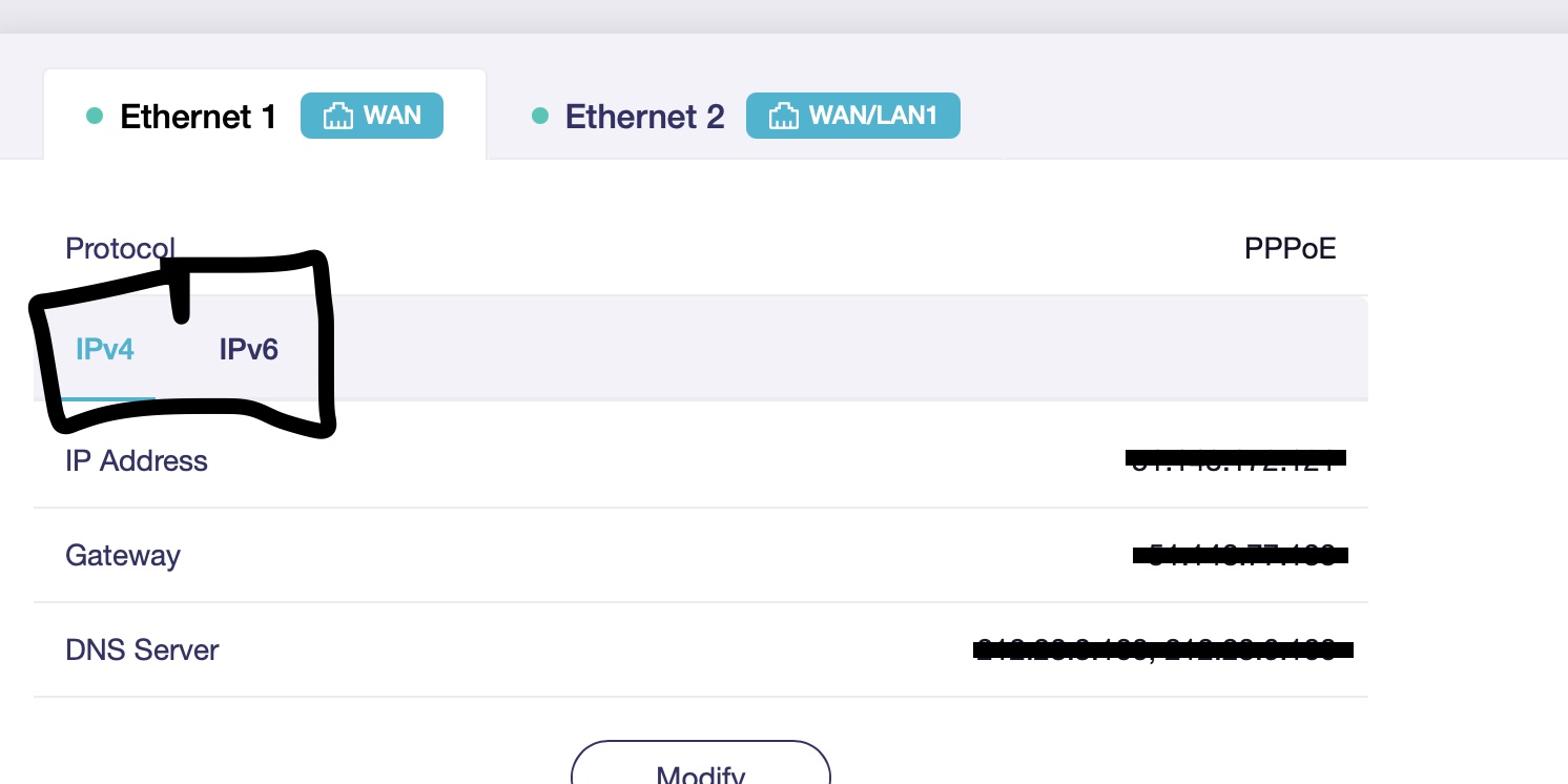

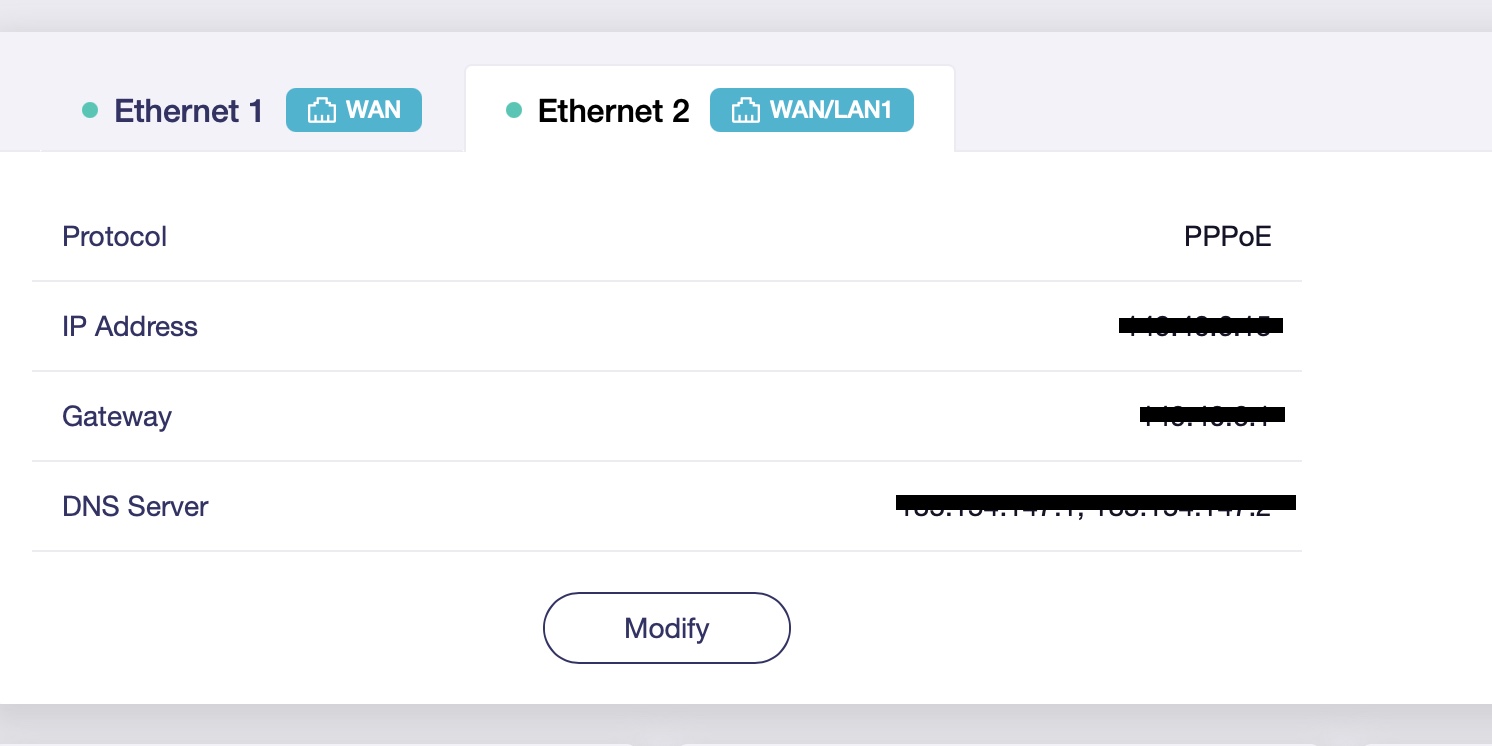

I just got another Fibre line activated in my household to take full advantage of Dual WAN Capability of the Flint2.
However, it seems you are only able to have IPv6 on Ethernet WAN1. There is not option for the Secondary WAN.
I am running OpenWrt 21.02-SNAPSHOT latest firmware, this was present on the firmware before as I only updated it today after the new installation.
As you can see via the screenshots - there is a IPv6 tab on WAN1 and no such option on WAN2.
This is also causing oddly that when I am connected to WAN2 - as the primary connection, devices still attempt to use the IPv6 addresses from the WAN1 with about 50% packet loss, which in turn is causing issues.
Any assistance here would be appreciated.
EDIT: After further digging, it does look like devices are getting a v6 address from the 2nd WAN, but say I ping something from terminal, it will use WAN1 v6 addressing. I go to a site like test-ipv6.com it uses the v6 address from the 2nd WAN.

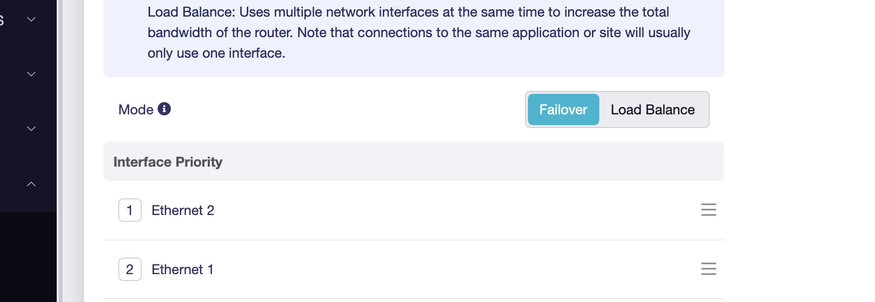

Firstly, yes, the Dual wan is set up and Failover.
I have put the priority so that WAN2 is first and test this via a trace route on v4 on a Mac. I do a trace route on v6 and it will use the WAN1 v6 address.
