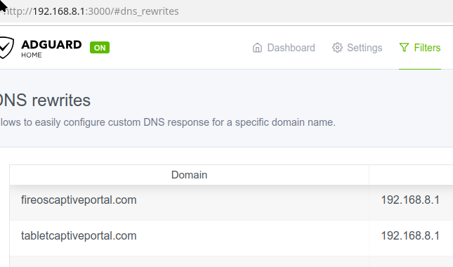

  4. Create the following rewrite rules from AdGuard (http://192.168.8.1:3000/#dns_rewrites):

The rewrite rules are actually:
fireoscaptiveportal.com => 192.168.8.1
tabletcaptiveportal.com => 192.168.8.1
firetvcaptiveportal.com => 192.168.8.1
with 192.168.8.1 being the address of the router of course. This way, the /generate_204 requests get served locally ,it seems to be working flawlessly.
