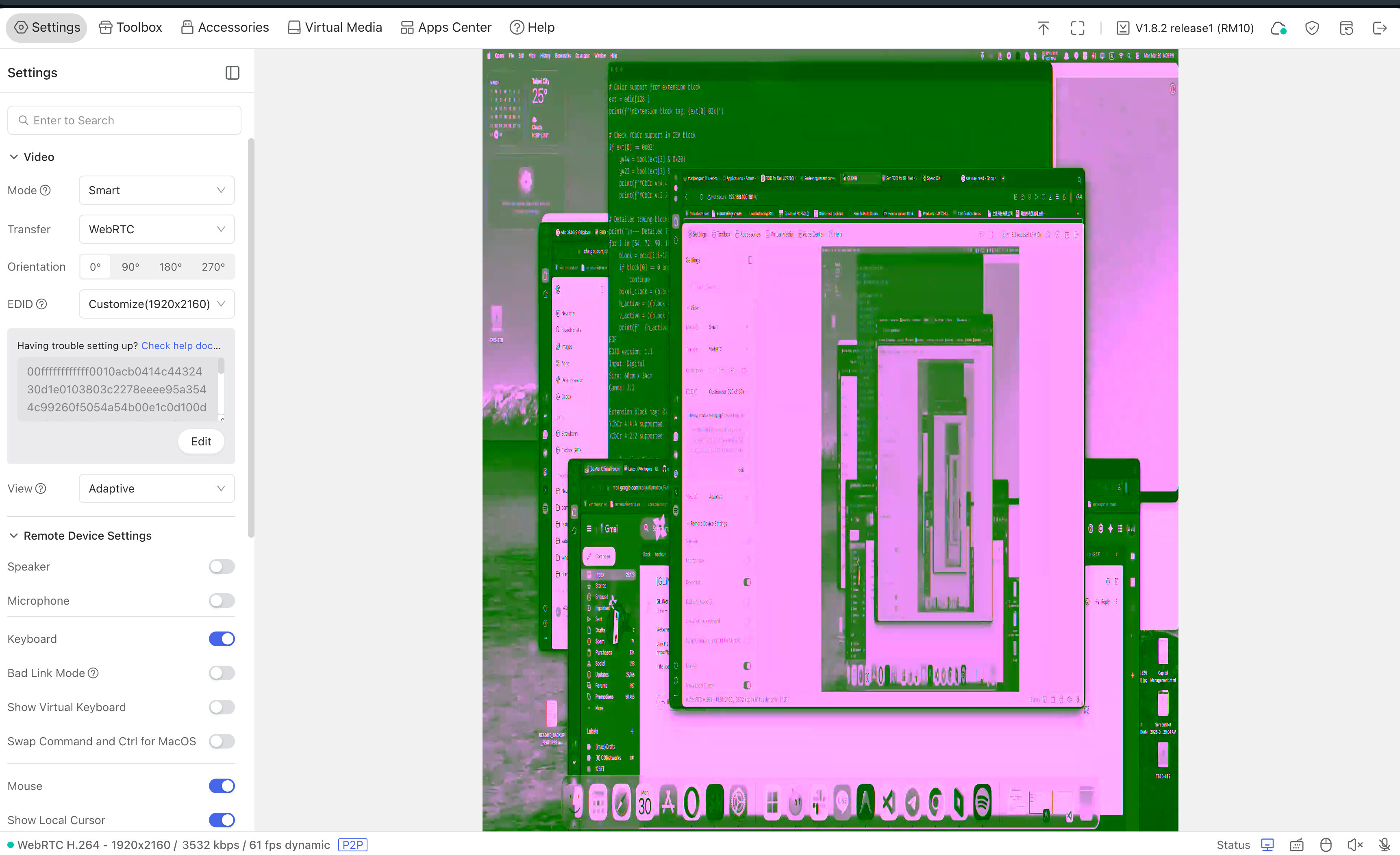

I just got the the GL-RM10 today and I want to use it with Mac mini m4 setup . my basic setup is like
Mac mini M4 with Dell U2720Q screen and default resolution is 3840x2160x60Hz
I try to extract EDID from mac, below hex are the info I’ve pull out from Mac
00ffffffffffff0010acb0414c4432430d1e0103803c2278eeee95a3544c99260f5054a54b00e1c0d100d1c0b300a94081808100714f08e80030f2705a80b0588a0055502100001e000000ff0048394e505431330a2020202020000000fc0044454c4c205532373230510a20000000fd00184b1e8c3c000a202020202020019d020338f15261605f5e5d101f051404131211030207060123097f07830100006d030c001000383c20006001020367d85dc401788003e20f0304740030f2705a80b0588a0055502100001e565e00a0a0a029503020350055502100001a114400a0800025503020360055502100001a0000000000000000000000000000000000e8
The monitor on mac is display correctly with U2720q on Display , but in UI i’s not render correctly.
If I use 3840x2160/GLKVM/30z , seems every thing display correctly , on screen and UI , but the problem is refresh rate is 30Hz , expect it to work at 60Hz. would be nice , is there any recommend settings for this setup ?
Thank you.
