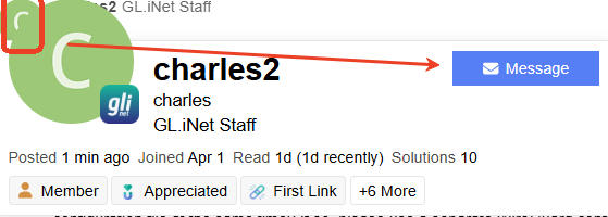

If the error remains after rebooting, please do not reboot the router again immediately. Please export the system log and send it to us via private message, together with a screenshot of the DNS page and the packet-capture result.
