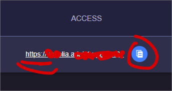

Your link url should be like https://xxxxxxx if you choose HTTP to HTTPS. It start with https not http.
So I guess you maybe mistake it. I tested and got the same error if use http way to visit the url of HTTP to HTTPS.
You could check it like below, the link urls of
HTTP and
HTTP to HTTPS are not the same.

I use this link.
As soon as i paste it in the browser, it redirects to an HTTP link.
Oh i understand what’s happening.
The target web page redirects to a local HTTP url (instead of https), and astrorelay does not rewrite the URL with HTTPs
