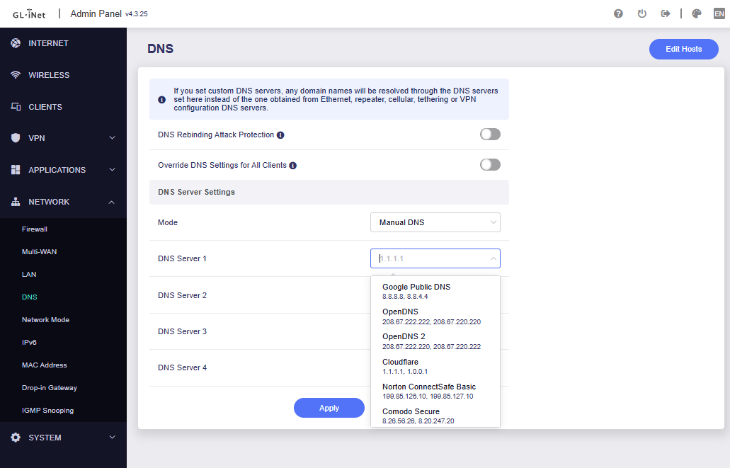

Could you please try the following:
  • Please go to NETWORK → DNS, set Mode to Manual DNS, and select another DNS provider, such as Cloudflare or Google Public DNS, from the DNS Server 1 drop-down list.
    Then try accessing mullvad.net and adding the Mullvad account again.
  • If possible, please connect the Mango to a different Internet source, such as a mobile hotspot, and test again.
Thanks, changed the dns, and back up and running. Appreciate the help
