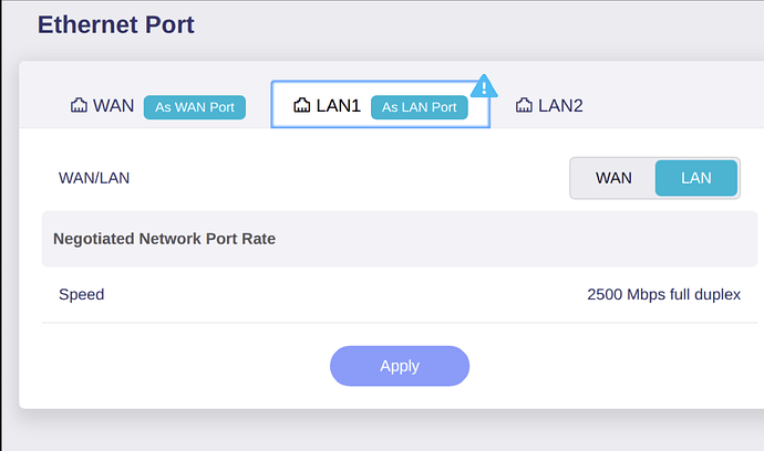

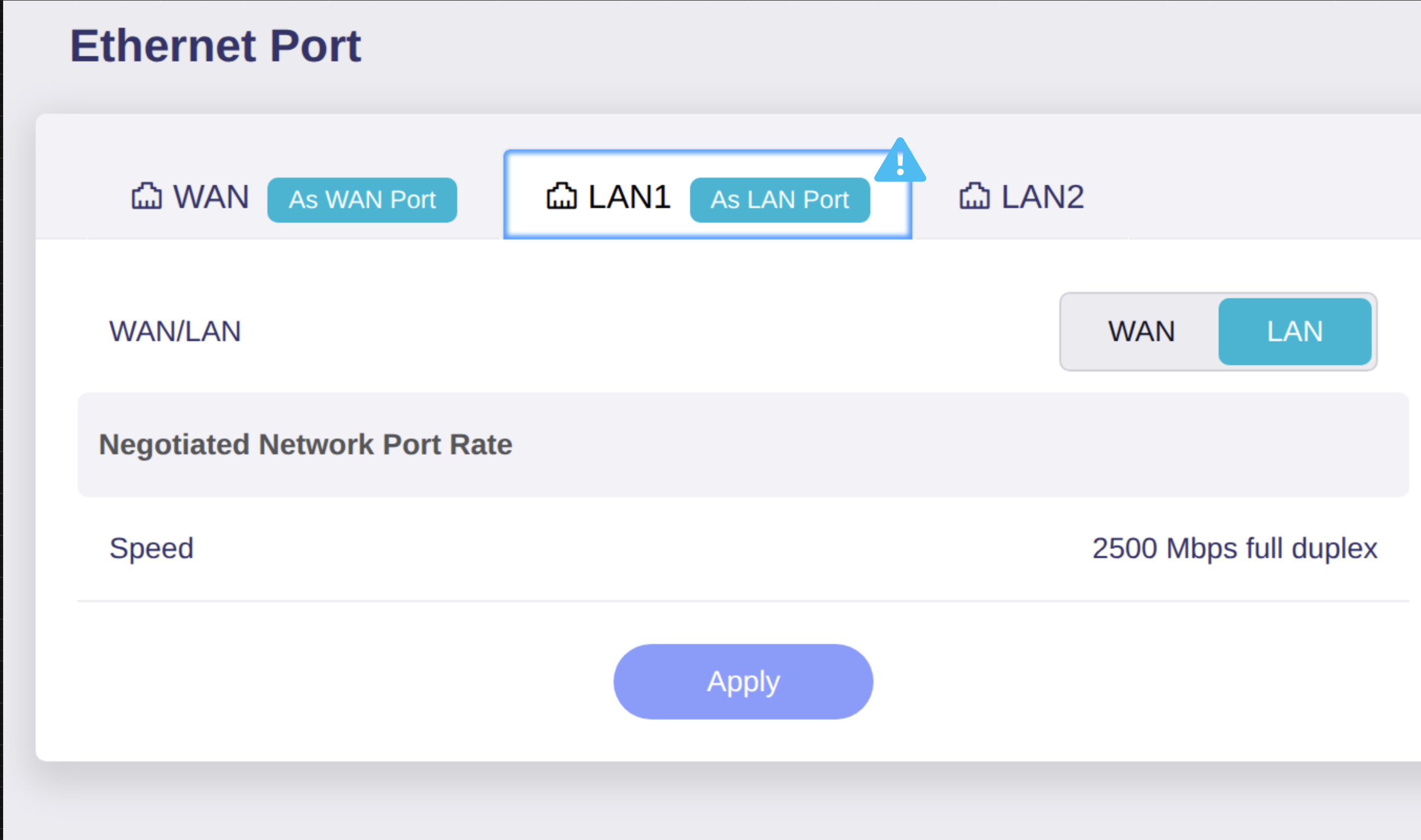

I understand, maybe it can be a bit hidden for the user to not make mistakes.
It could also be brought as a suggestion when a port is negotiated as 100M like so:
when a user hovers over the alert symbol, it explains it is recommended to disable flow control only on this port, and only then this option is visible.
(please ignore the 2500mbps on this screenshot it should be 100M :P)
as for possible driver incompatibilities that will then be the only issue.
