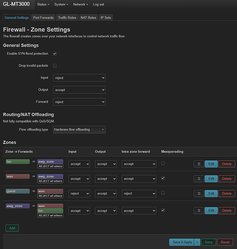

After installing the packages in step 2, I had to reboot the MT-3000 (Beryl). This step is not mentioned/missing in the guide. Otherwise, the protocol "AmneziaWG VPN" was not selectable / did not appear in the dropdown list for Step 4.1 "Create new interface".
In step 5, I was able to manually enter a firewall zone name like "awg_zone". The web interface did mention "(create)" next to it, but did not offer to configure the zone as mentioned (e.g. for setting Input/Output/Forward to accept). So I had to manually change to Network/Firewall later and modify the corresponding entry.
Then my problem was:
The AWG connection to the peer seems to be OK and working. Checking Status/AmneziaWG I see traffic received and transmitted on the interface including last handshake timestamp. However, I couldn't manage to establish a connection from the laptop (connected via wifi to the MT-3000) to the internet via the AmneziaWG interface. I could not get it working with firmware version 4.6.6 and also not with version 4.7.5, which I tried in addition.
I want to have all LAN/wifi traffic of the MT-3000 exclusively routed via the AmneziaWG interface, without having any traffic bypassing the VPN (for usage in a restricted country).
So -- while I prepared this for a post to ask how to set it up, I managed to configure it (hopefully properly). Please find here some screenshots of the required firewall configuration (based on version 4.7.5):
AND BY THE WAY -- with 4.7.5, LuCI is on port 8080 --> http://192.168.8.1:8080/cgi-bin/luci
HTH somebody else running into the same issue.

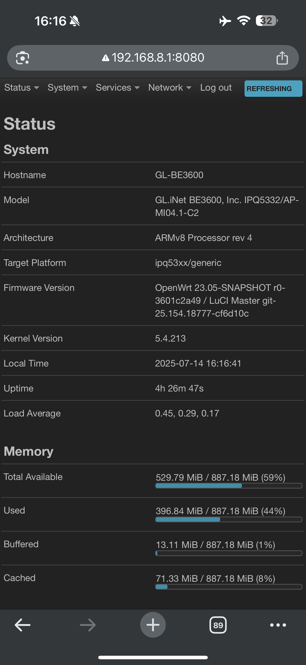

Hello, I buy be3600 (state 7 router)!!! How to install amnesiawg on this?!

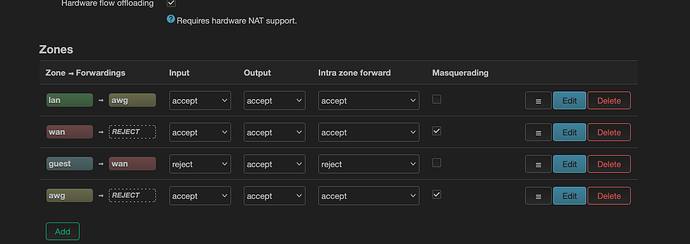

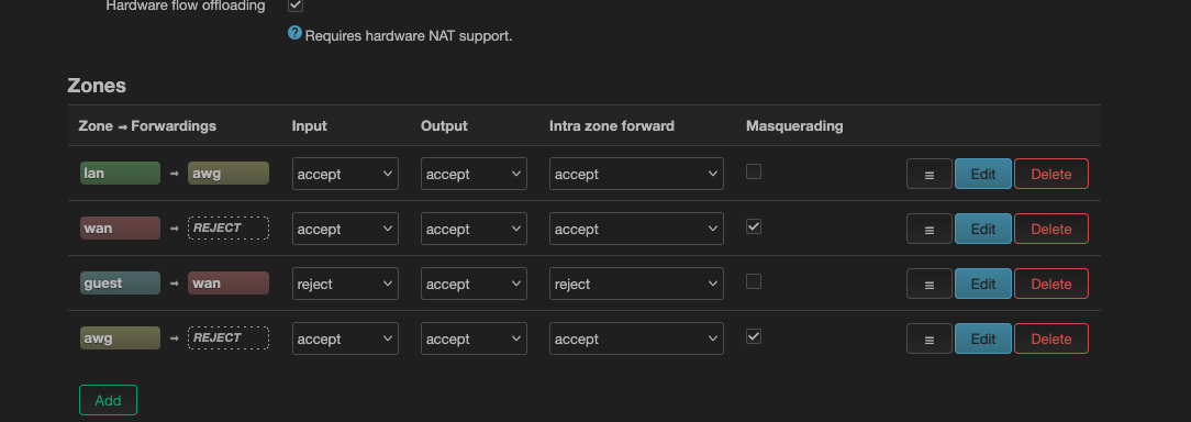

Thats work for me
But the main thing why it didn't work before was missing default route via awg interface
Don't forget to switch it on NETWORK-->INTERFACES-->AWG interface-->peers-->Route Allowed IPs
apply and restart the interface
