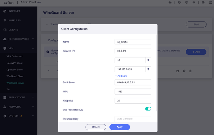

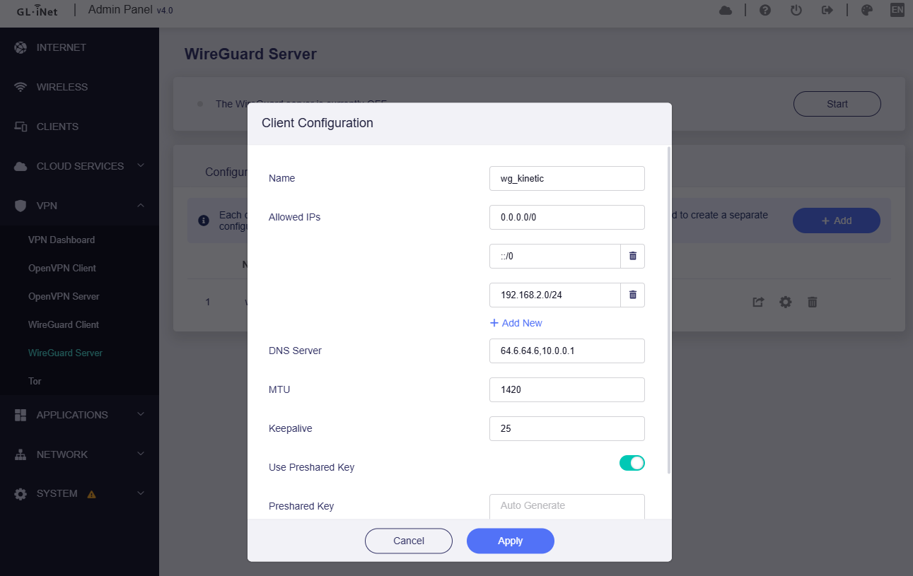

When setting up a Wiregaurd Server

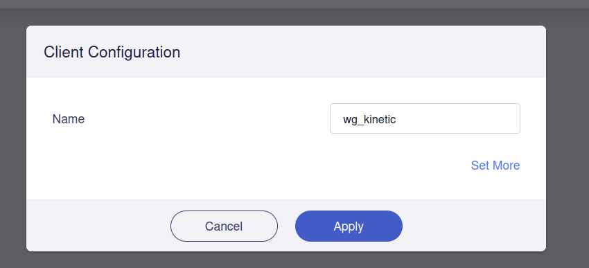

The client configuration screen does not seem to work.
Clicking the Apply button makes the screen blink but otherwise does nothing.
Expanding the options I do not see a place to enter the public key.

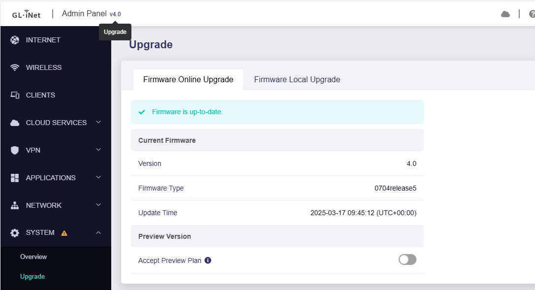

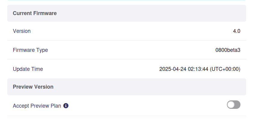

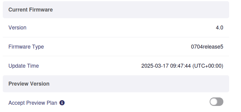

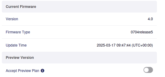

May I know what firmware version of your X3000/XE3000 is?
I have been using the 4.8 beta
Adding Allowed IPs ≠ Route Allowed IPs
The Wireguard client does not appear to route the allowed IPs nor does it have an option to enable/disable it.
I reflashed back to 4.7

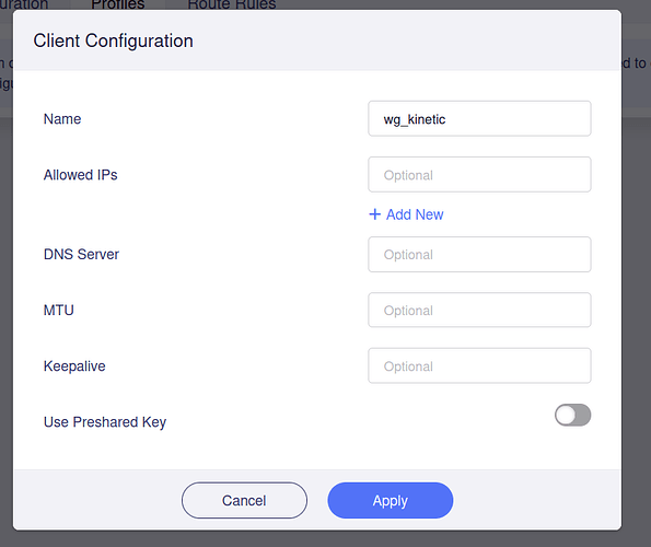

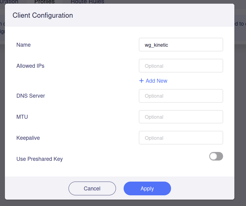

I can now configure a Wiregaurd server but the software will not let me assign an IP for the clients.
Can I edit the assigned IP in a config file somewhere?
There's no location to set the endpoint and port for a client. Bloody hell.
