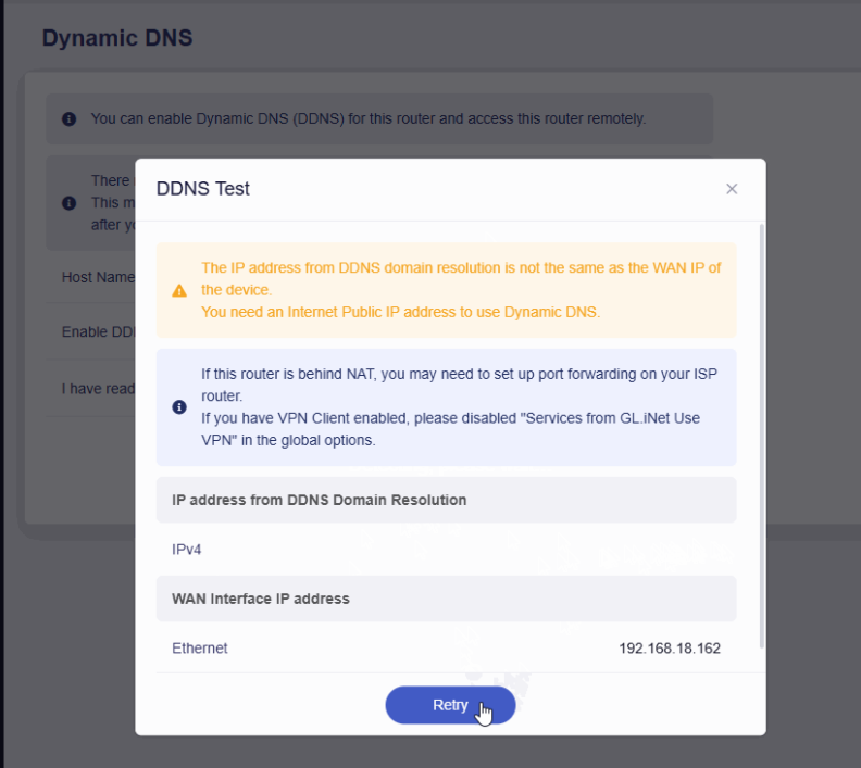

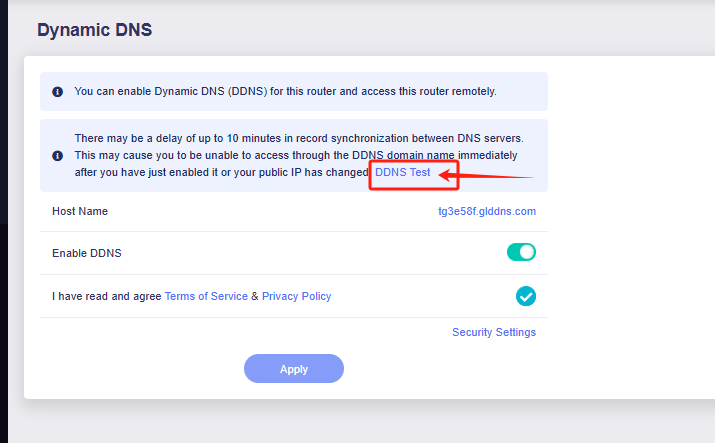

When your B3000 router has a DDNS problem, what will happen if you click DDNS TEST?
I have performed a local test and it seems that this problem has been reproduced.

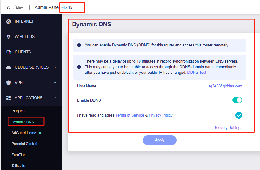

I think B3000 V4.7.15 beta version solves this problem, you can try to upgrade to V4.7.15 beta firmware.
I just installed the beta release and now my router is stuck in Luci mode and has no option for DDNS
Please try restarting your router and confirm the version information.
The V4.7.15 beta version definitely has the DDNS option.
