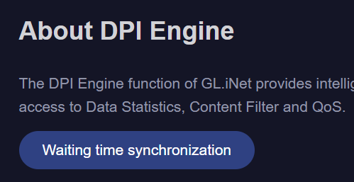

All seems to work in
SYSTEM → TIME ZONES
…and still no DPI progress
what else should i do?
Could you please export the logs so we can take a look? PM me or Bruce, thanks.

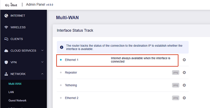

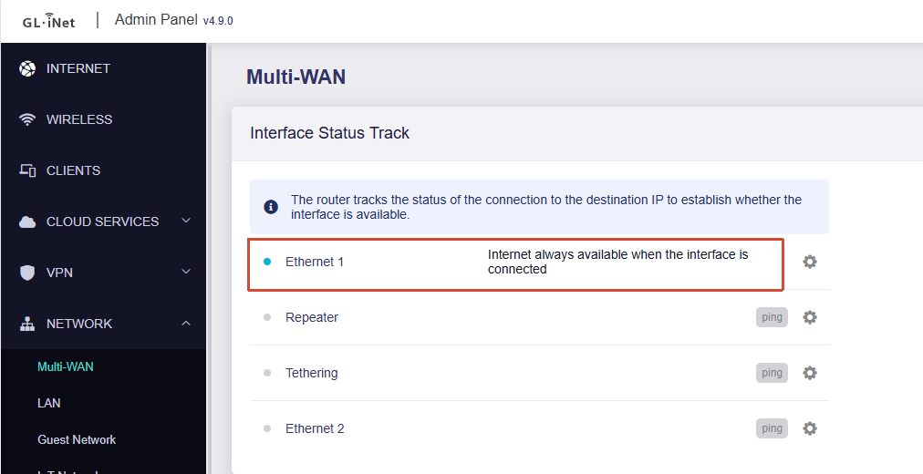

Thank @True0Man for sharing the logs and remote access.
After remote checking, we found that the current DPI time synchronization completion flag depends on the Multi-WAN functionality.
When Multi-WAN is disabled, the related flag may fail to be created correctly.
We have already asked the development team to further fix this issue.
For other users who encounter this issue, please update to the latest v4.9.0 beta firmware, and then switch the time zone once in “Admin Panel → System → Time Zone” (you can switch it back to the correct one afterward) as a temporary workaround.
After waiting a moment for the NTP/NTS time synchronization to complete, you should be able to enable DPI normally.
