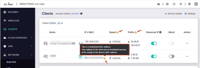

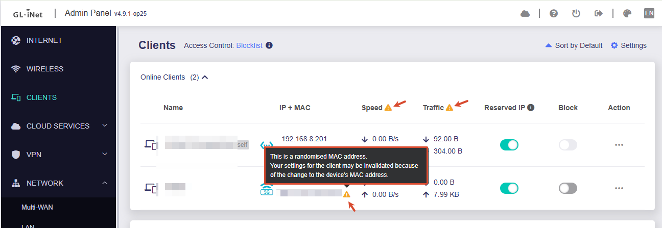

Which "warning" label are you referring to?
You can move your mouse over the label, and it should display the corresponding explanation:

I don't have a computer at the moment, but you got the orange triangle right. That's what I see with my phone. The message is: “The reserved IP is not in the same network segment as the current IP, the configuration does not take effect.”

If this "warning" label appears when configuring a Reserved IP for a Guest / IoT device, then it should be a known issue.
The Reserved IP function itself should work normally, if the reserved IP address is still within the Guest / IoT network. We plan to optimize this warning message in future firmware versions.

As I mentioned earlier, the warning label appears when configuring a reserved IP for a Guest/IoT device. So, are you saying that despite the warning, the reserved IP setting does work? What's actually causing this problem, and will there be a fix in the near future like v4.10? I'm actually surprised this is even a problem.

We have a mechanism to check whether the user-configured Reserved IP is within the Main LAN subnet range. Obviously, if the IP address is outside the subnet range, the configuration will not take effect.
However, the current check does not consider the Guest / IoT network scenarios. Therefore, when configuring a Reserved IP for a Guest / IoT device, this warning message may appear even if the IP address is within the corresponding Guest / IoT subnet range.
This is only a display issue. The Reserved IP function itself should still work as expected, as long as the reserved IP is within the correct subnet range.

How do I know if the IP address is outside the subnet range? I don't even see an option to set the IP address. I only see the toggle to reserve it.

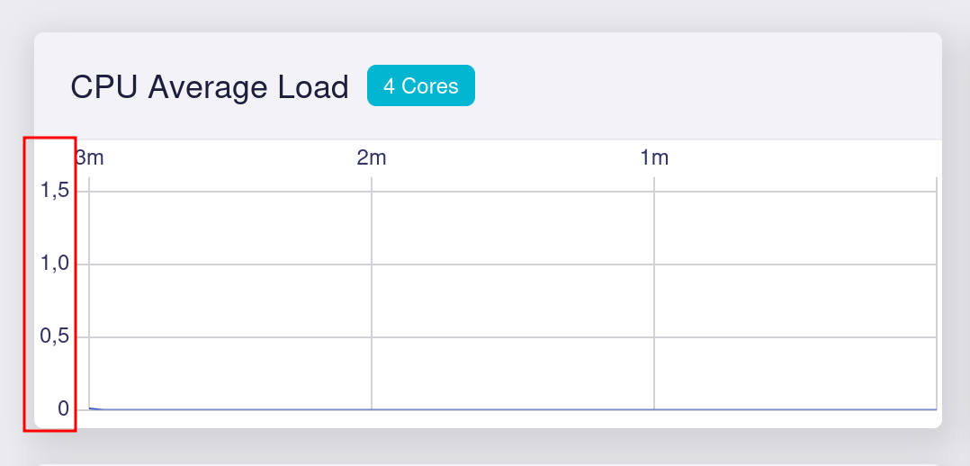

what is this value?

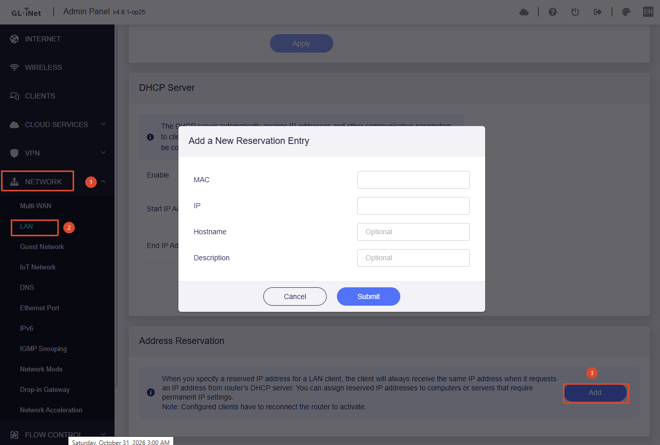

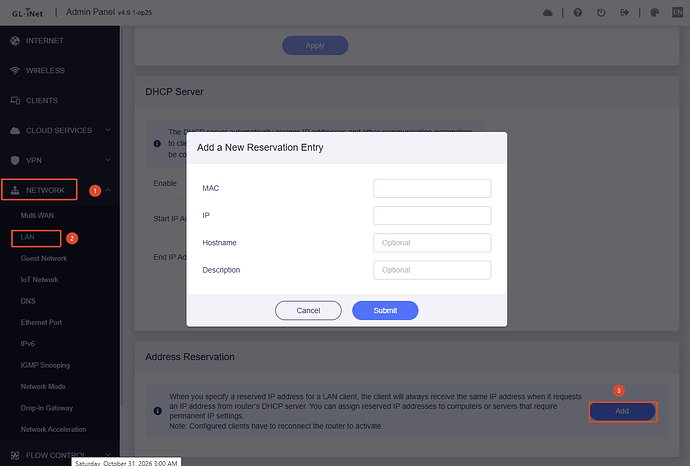

If you are simply using the Reserved IP button, there is no need to worry about the address falling outside the subnet range.
You can specify a custom IP address under Admin Panel → Network → LAN → Address Reservation.
This is not the CPU usage percentage. It represents total CPU consumption per individual CPU core.
For multi-core devices (such as the MT6000 with a quad-core CPU), the value can exceed 1. For the MT6000, the reasonable maximum value is 4.

In some cases, the value may even exceed the number of physical CPU cores if the currently running processes require more resources than the available limit.
