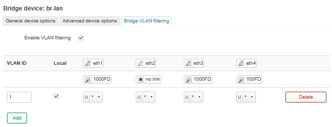

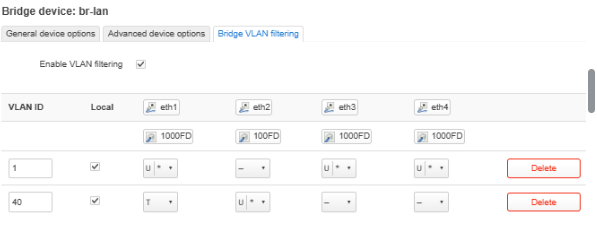

LuCI Web UI:
  1. Network > Interfaces > Devices.
  2. br-lan and click “Configure”.
  3. “Bridge VLAN filtering” tab.
  4. Check “Enable VLAN filtering”.
  5. Configure VLAN 1 (LAN)
  6. Click “Save”.
As far as i know, with this config, all eth ports are in the same vlan (vlan1) and all ports can manage untagged packets, treating them as vlan 1 packets.
Summing up, all devices should be in the same vlan and work as when there were in the LAN.

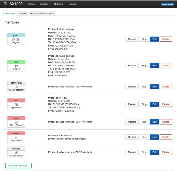

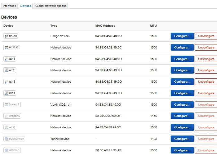

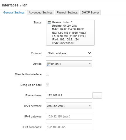

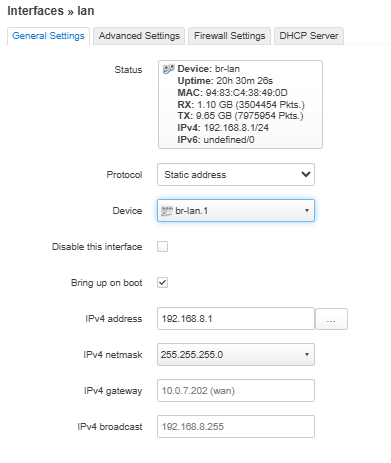

After that, I modifed the LAN interface in order to asociate with the new vlan.
LuCI Web UI:
  1. Network > Interfaces.
  2. Edit lan Interface:
  3. “General Settings”, “br-lan.1”.
  4. Click “Save”.
After that Save and Apply.

Please try upgrading the AX1800 firmware to the latest v4.8.3 beta and test again.
Also, if you are configuring only a single VLAN ID, there is no need to enable PVID.

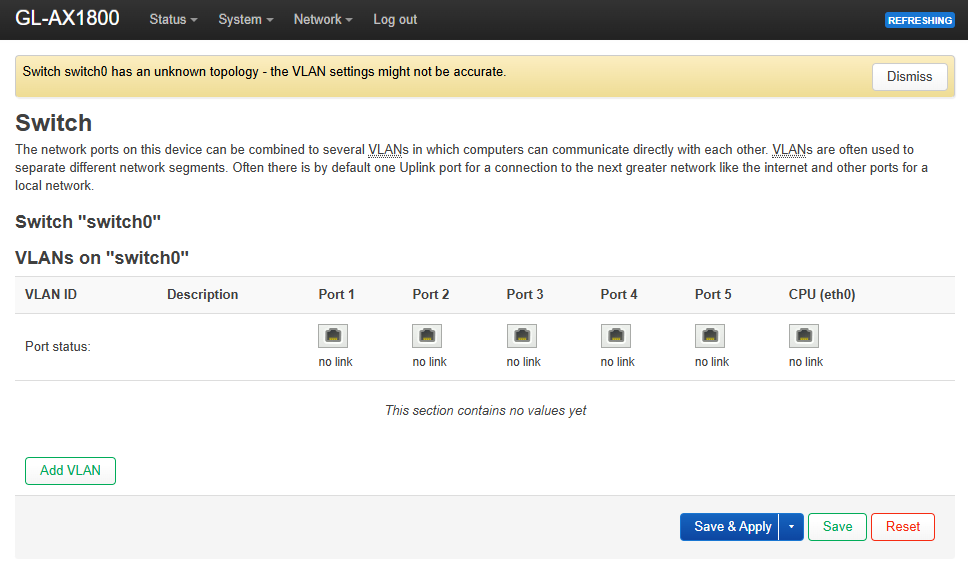

Reading the info you sent me there is an option that I din’t do.
Network → switch
Do I have to add the vlan1 also in the switch if it’s added to the br-lan device?
Is this what i was missing?

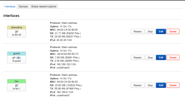

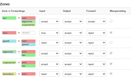

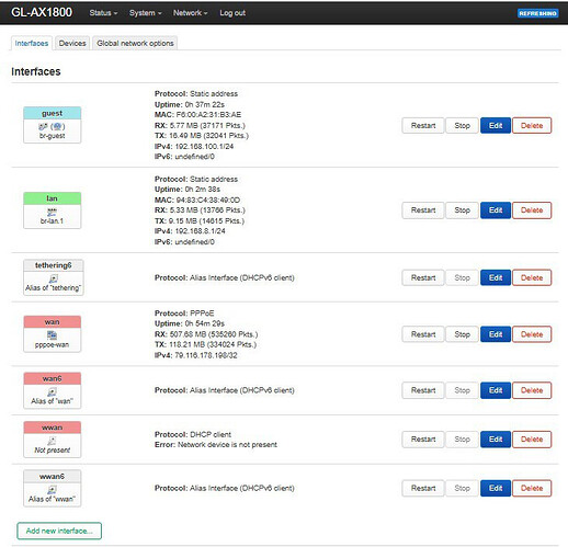

More info: The final goal is this:
With this two interfaces
And this FW configuration
Thanks!!

Finally I’ve updated to 4.8.3 beta and apply the same configuration and works!

Going back to the question in the post, I have added a new vlan (40) and configured everything.
Something interesting has happened.
The devices in the new vlan did not obtain IP and if I configured it by hand they did not reach the flint interface (ping)
I've spent quite a bit of time going over settings etc and everything seemed fine so I decided to restart Flint as a last resort and it worked.
That is, in my case a Flint restart was required for the new Vlan configuration to work correctly.
