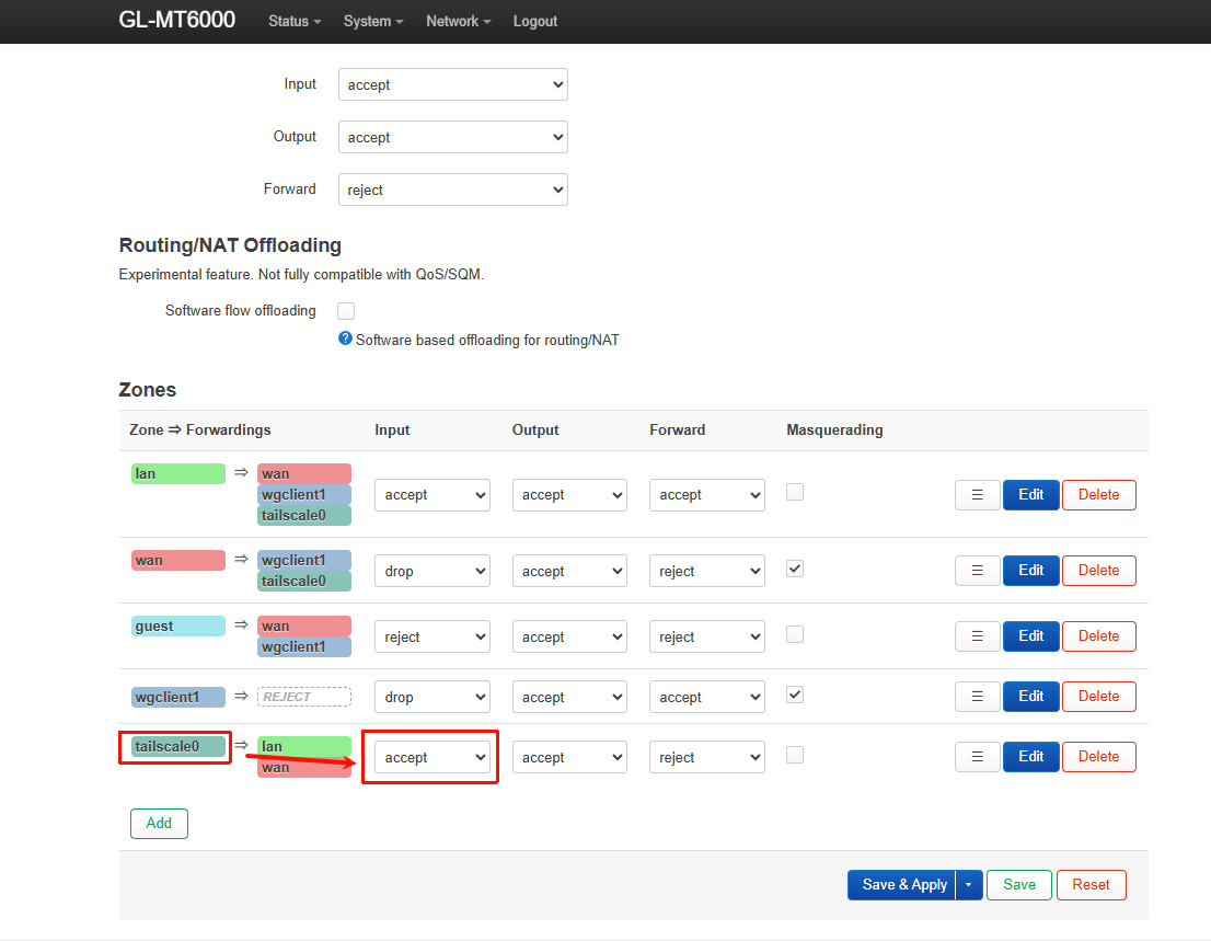

What i tried:
I went to Lucy and i edited the firewall settings to accept bridge between Lan/wan/tailscale0.
I activated the masquearade also (dont know why but read it somewhere)
I updated the tailscale software to latest, and i checked the MTU that is 1280.
All problems still presist.

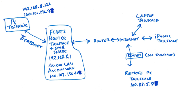

Could you clarify where Tailscale is running?
From your description, it sounds like it’s also running on the Mac to remotely access the SMB volume on the Flint 2.
If possible, please try to draw a simple topology so we can better understand the issue.
Note to indicate the role of each device (e.g., which one is running Tailscale and which one is the SMB server), as well as their IP addresses.
Hello thanks for your reply, i really appreciate it.
I made a real picasso drawing so i hope you enjoy art :slight_smile: se attachment.
  1. So i have a PC, it is running tailscale and is connected to my flint 2 router running tailscale. Tailscale works when i acces the router from remote location on tailscale network IP.
  2. On the flint 2 router there is also a SMB server running. verified it works with the PC.
  3. The SMB server works fine if i turn off tailscale on the router and keep it on in the PC (OSX), however if i have tailscale “on” - both devices i stops responding to connections.
My intention is to have tailscale running on the flint 2 router, and simultanious SMB sharing, so that i can reach the SMB disk from any portable device including smart TV and so on, or stationary PC, that is connected to my tailscale network.
There is also a remot PC connected to the same tailscale network, i also want that PC to access the SMB share from the flint 2 router that is on a remote location.
The Flint 2 router sits behind another router, so the IP on the flint router is:
192.168.8.1 internal network ip
192.168.3.3 external network ip (wan port)
and also it has a tailscale IP 100.107.136.10X
The PC (OSX) connected to the tailscale router with ethernet is running on IP:
192.168.8.122 (LAN)
100.126.196.9X (tailscale)
I tried connecting to the router SMB IP 192.168.8.1 when tailscale is off, then it works, if i keep that connection on local IP and turn tailscale back on (on the router) i can also connect on the tailscale IP 100.107.136.10X. However, if i unmount the first session on local IP, it will not respond to tailscale session request.
Does this answer the questions you need?

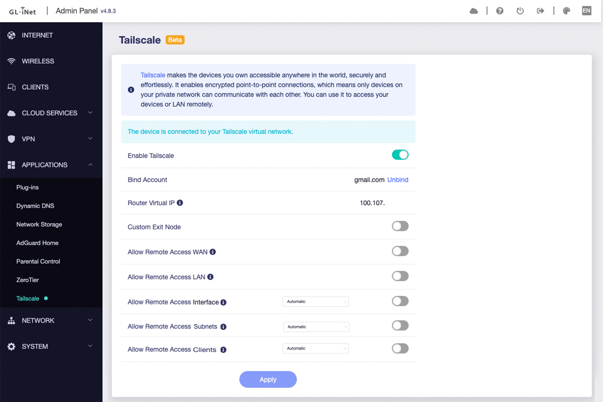

Had the same problems quite a few times.
Try this: Turn completely OFF Tailscale and wait a few seconds.
Then turn ON Tailscale, BUT ONLY THE FIRST TOGGLE SWITCH. Wait a few seconds.
Then turn ON Allow Remote Access LAN (or WAN if you need it) and wait again a few seconds.
Try your connection.
Basically everytime I enabled all the toggles switches too fast I had the same problem, enabling them one by one solves the problem for me for some reason.

Now i just did what you said, and i turn off everything and i wait. Then i toggle back ONLY the first Toggle. I leave WAN and LAN toggles OFF.
  • Enable Tailscale ON
  • 100.107.136.1XX
  • Custom Exit Node OFF
  • Allow Remote Access WAN OFF
  • Allow Remote Access LAN OFF
Also i added some rule in the firewall, i dont know if this helps or not but:
Firewall - Traffic Rules - Tailscale regel
Name
  • Tailscale
Protocol
  • TCP
Source zone
  • tailscale0(empty)**
Source address
  • -- add IP --
Source port
  • any
Destination zone
  • Device (input)
Destination address
  • -- add IP --
Destination port
  • 443 139
Action

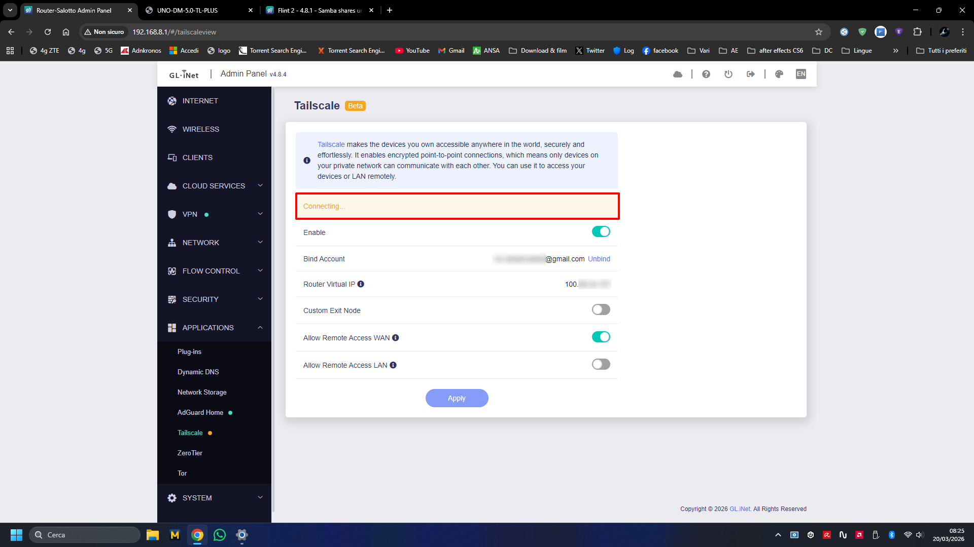

Yeah, when you change settings there is this wait time:
unknown_2026.03.20-08.25_1
But then, when it goes away there is this:
and the problem usually arise when you enable WAN and LAN access together and click apply WITHOUT waiting for "connecting..." to disappear.
It's not consistent to reproduce and unfortunately I have no time at the moment, but usually it happens more easily when you first bind your device to Tailscale.

I want to add the fact that i added a rule in the firewall, that keeps the ports open from tailscale interface to the device. I dont know if this helps but now as it is working i will not change anything.

Tailscale ON, WAN OFF, LAN OFF
Tailscale ON, WAN ON, LAN OFF
Tailscale ON, WAN OFF, LAN ON

If you, in future upgrades, could add these features as shown in the attached image, it would increase the value of the tailscale integration by a exponential magnitude, as there is lots of smaller units that cant run tailscale and needs it through the router. At the same time, some users dont want to expose all the network, or all the clients, interfaces or subnets to the tailscale network. This forces us to use multiple routers in the home with different configurations, but it can be solved from one unit if firmware allowed for easy setup.
If these 3 extra options were added, and they would automatically configure the firewall/routing tabeles according to the users needs, it would be not even one inch short of fantastic:
Activating tailscale only for selected interfaces, subnets or clients. Thus allowing the user to use tailscale for example ONLY on one of the WiFi SSIDs, or only on the LAN, or only for a few chosen connected clients or a special subnet on the router. Using popdown menues to choose whatever is best suited for the user.
Activating the service “allow remote access clients” would present the user with a list of all clients connected to the router, and just use “checkbox” to mark what clients to be connected to tailscale.
Or similar with “allow remote acces subnet” would present user with a list of avalible subnets on the router, and then allow the user to make a dedicated subnet for one WiFi channel, and connect that WiFi SSID to tailscale while rest of clients are not exposed to tailscale.
Same feature would go for interface, allowing the user to activate this feature and only connect tailscale to a dedicated interface, like ethernet ports or wifi.
I dont know how much time would be needed to add these features, but i would be happy if any of the developers could qote a time estimation for developing this feature.

  • Regarding whether firewall configuration is needed for Tailscale: by default, access from Tailscale to the device itself is already allowed, so no additional configuration is required.
