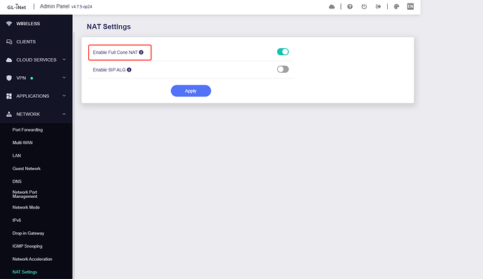

  1. Does inseego m3000 support "modem bridge" mode? If supported, you can switch it to this mode, it will hand over the modem IP obtained by ISP to the WAN of Flint2.

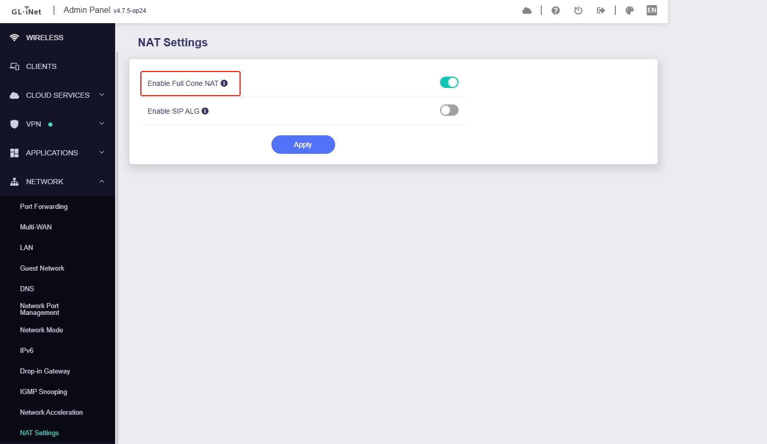

  2. Try to enable Flint2's Full Cone NAT in GL GUI > Network > NAT settings
  3. Please try to install the plugin upnp.
I have enabled modem bridge on my inseego m3000. The internet works, but the issue mentioned before persists.
I have enabled full cone nat. The internet works, but the issue mentioned before persists.
I have also installed upnp via luci-app-upnp (git-20.332.74200-03c77da) and enabled the Start UPnP and NAT-PMP service and UPnP functionality, same issue. All 3 things mentioned above are now enabled or attempted, and the issue still persists.
