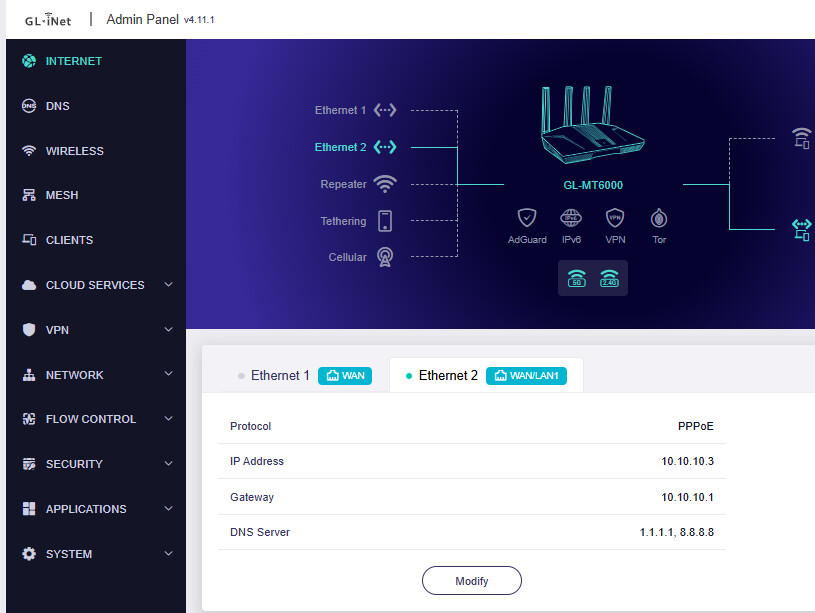

I'm having the same issue on the stable 4.11.0 release. PPPoE still dials, but only on WAN port . Once it connects, only the router has internet access; the clients don't. When I check the client list, it's completely empty . DHCP shows nothing unusual . client cant ping 1.1.1.1 . However, when I ping through the router's SSH, it works fine, meaning there is internet inside the router but clients cannot access the internet.
Since PPPoE connects and the router itself has Internet access, the next step is to distinguish a LAN/DHCP problem from a forwarding or DNS problem.
Connect one computer directly to a LAN port, disable its Wi-Fi, and report:
  1. The IP address it receives—only the subnet, such as 192.168.8.x; do not post identifiers.
  2. Whether it can ping 192.168.8.1.
  3. Whether it can ping 1.1.1.1.
  4. Whether it can resolve and ping example.com.
If 1.1.1.1 works but example.com does not, investigate DNS. If the gateway works but 1.1.1.1 fails, the problem is LAN-to-WAN forwarding. If no 192.168.8.x address is assigned, it points to DHCP/LAN handling. Temporarily disable all VPN tunnels, “Block Non-VPN Traffic,” and Access Control if any are enabled, then repeat the test. Please send the results, exact 4.11.0 build, and a redacted log archive to charles2 by private message, not publicly.
