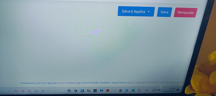

Wrong topic I guess?
:rofl::rofl::rofl::rofl::joy::rofl::joy::rofl::joy::rofl::joy::rofl::joy::rofl::joy::rofl::joy::rofl::rofl::joy:
Do you want us to understand that… you have installed a snapshot version with the latest kernel and the Italian language? :rofl::rofl::rofl::rofl:
WoW Argon theme :tada::tada:
I have the openWRT Stable running with argon and English if anyone wants to see those screen shots just let me know (jk) :joy: :joy: :joy: :joy: :joy: :joy:
