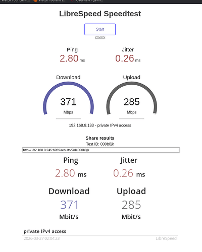

I'm running into a really frustrating speed issue with my Flint 2 and I’m trying to pin down why. I've already ruled out my ISP I ran a direct router-to-device LibreSpeed test and it's 100% showing that the bottleneck is happening internally. I’m struggling to even hit 400 Mbps down locally, and I'm barely even getting that most of the time.
To make matters worse, on a lot of my other devices when I run a speedtest, I’m barely getting 200 Mbps connecting to the internet as well.
I am not running any VPN software on the router or the devices, and both computers are directly connected via Ethernet, so it's not a Wi-Fi or encryption overhead issue. There is nothing else on my network pulling traffic right now, but the internal throughput is just tanking.
I really like this router and it's usually a beast, but this is a huge headache. I tried a firmware downgrade to troubleshoot, but that just killed my connection entirely, so I'm back on the latest stable build now and the problem is still there. I've checked my MTU and hardware settings, but I can't find anything that should be throttling the connection like this.
