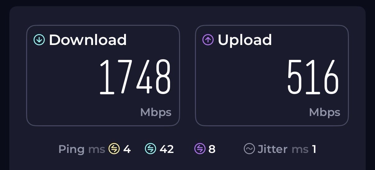

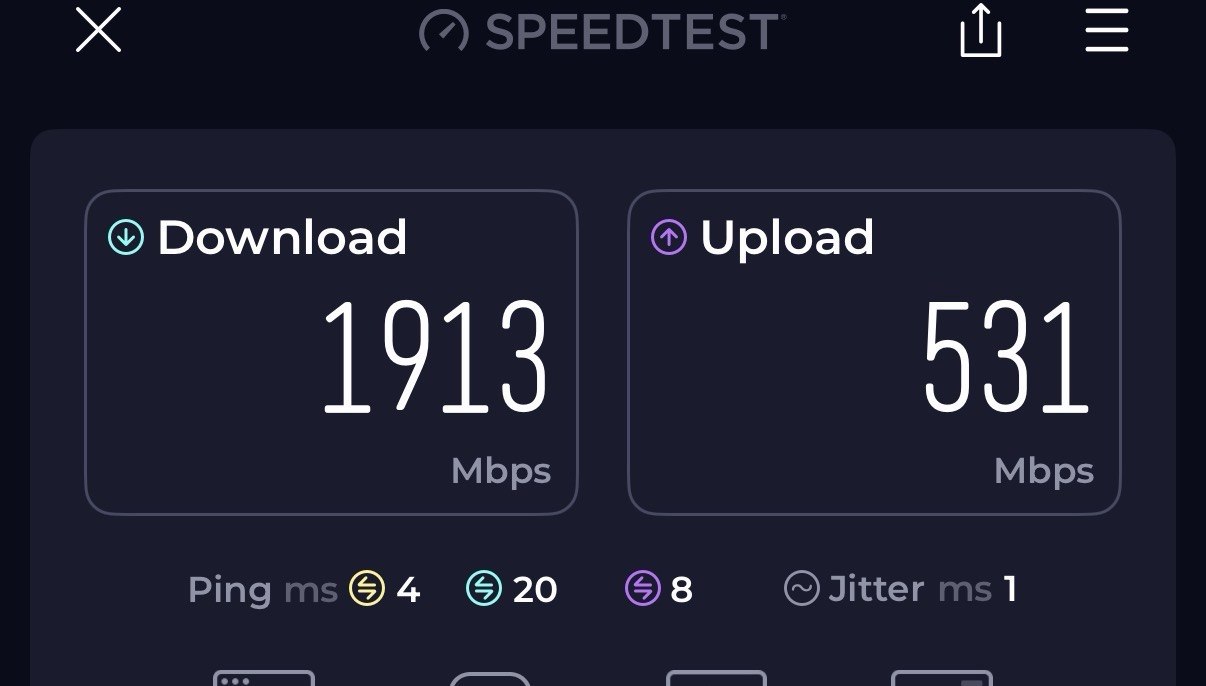

This isn't the first discussion I've read about Flint 2, but I've never found a real solution to this problem. I'm currently using version v4.9.0-op24, but I've also tried the "stock" versions and the problem was the same. The Ethernet connection is excellent, about 2.2Gbps download and 1Gbps upload. However, using Wi-Fi, with the latest-generation devices and 10cm from the router, I can reach a maximum of 1900Mbps download but only 500Mbps upload, exactly half. The problem is only with uploads; the Wi-Fi coverage is excellent. Does anyone have a solution?

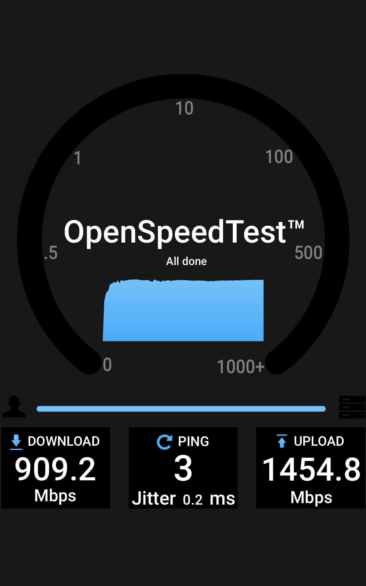

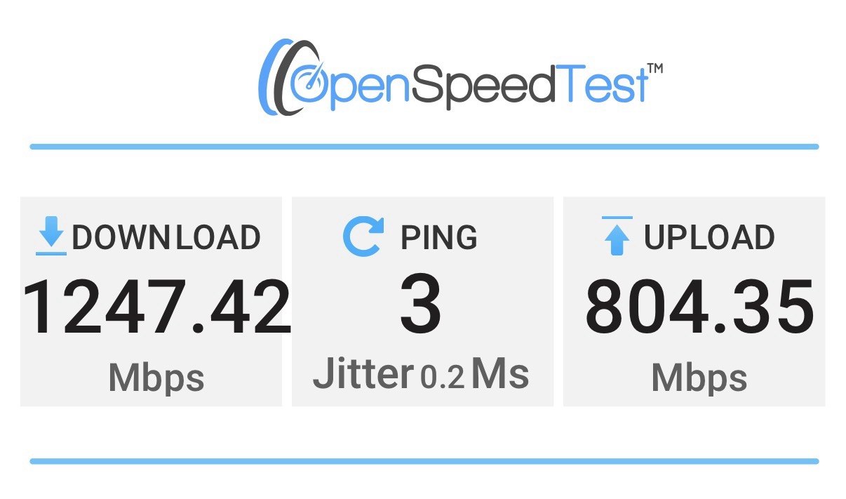

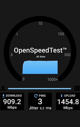

Openspeedtest in Wifi.. (Hardware acceleration is enabled, I already tried to enable/disable it, use software acceleration or automatic and it doesn't change the upload)

Thank you for the additional test results.
Based on the local OpenSpeedTest result, the Wi-Fi uplink itself appears to be working normally, so the reduced Internet upload speed is more likely occurring somewhere in the Wi-Fi-to-WAN forwarding path or between the Flint 2’s WAN and the upstream device.

Hi, I don't think the ONT has anything to do with it, with another router the upload reached 1 Gbps quietly with 1.8Gbps in download... also the openspeed result is strange, in the same location, same device, 1 minute later I tried with speedtest and this is what it shows..as I said it doesn't go beyond 500/550 Mbps, really strange thing. Isn't there a "simple" solution to solve this thing? It's the first time that a router has limited the upload in this way...

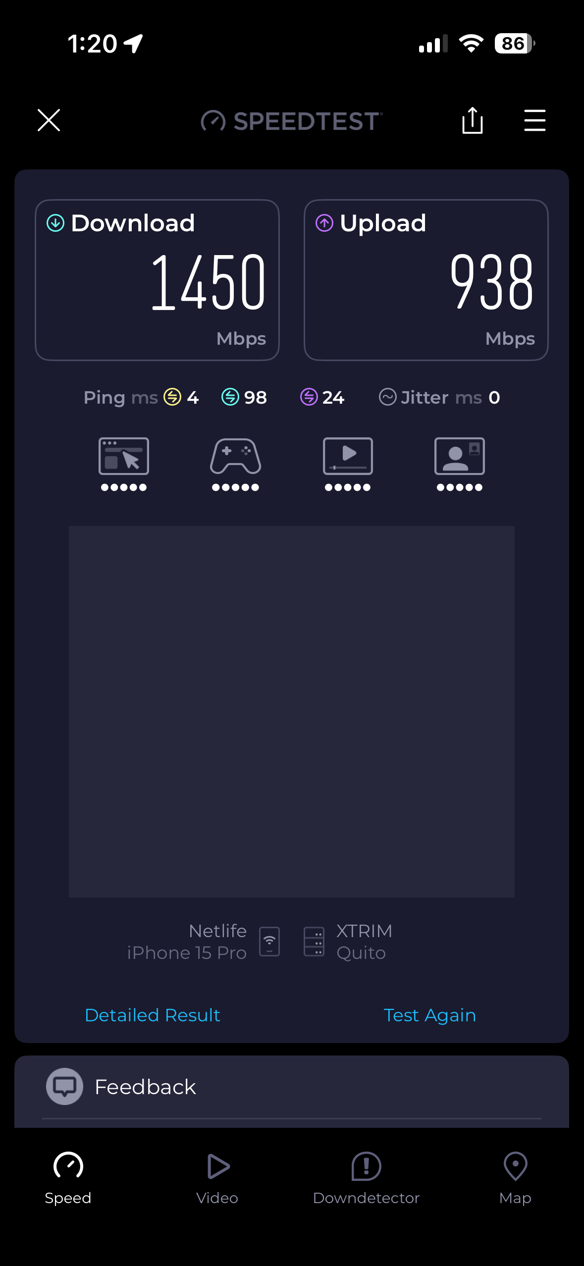

Hi Charles,

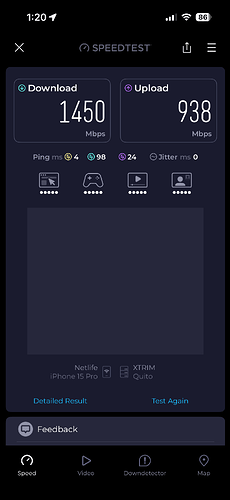

I installed the stock firmware 4.9.1. I can only attach 1 photo every post, I will attach the one from the first test, the other 2 I hope to be able to add them later.
Results of first test, using Wi-fi, same position, same server used previously with Speediest:
Second test using Wi-fi, same position with openspeedtest:
For the third test, I ran this text via ethernet from my Mac and terminal using the same server, as I have no idea how to enter via ssh from my iPhone:
