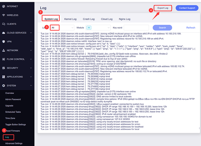

If it still doesn't connect, could you please do the following three steps:
  • Double‑check your PPPoE username and password
  • Set the correct VLAN ID if Digi UK requires it
  • Clone the MAC address of your previous router
After that, check if the router gets internet. If not, please export the full system log and send it to me via private message.
