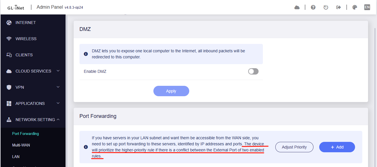

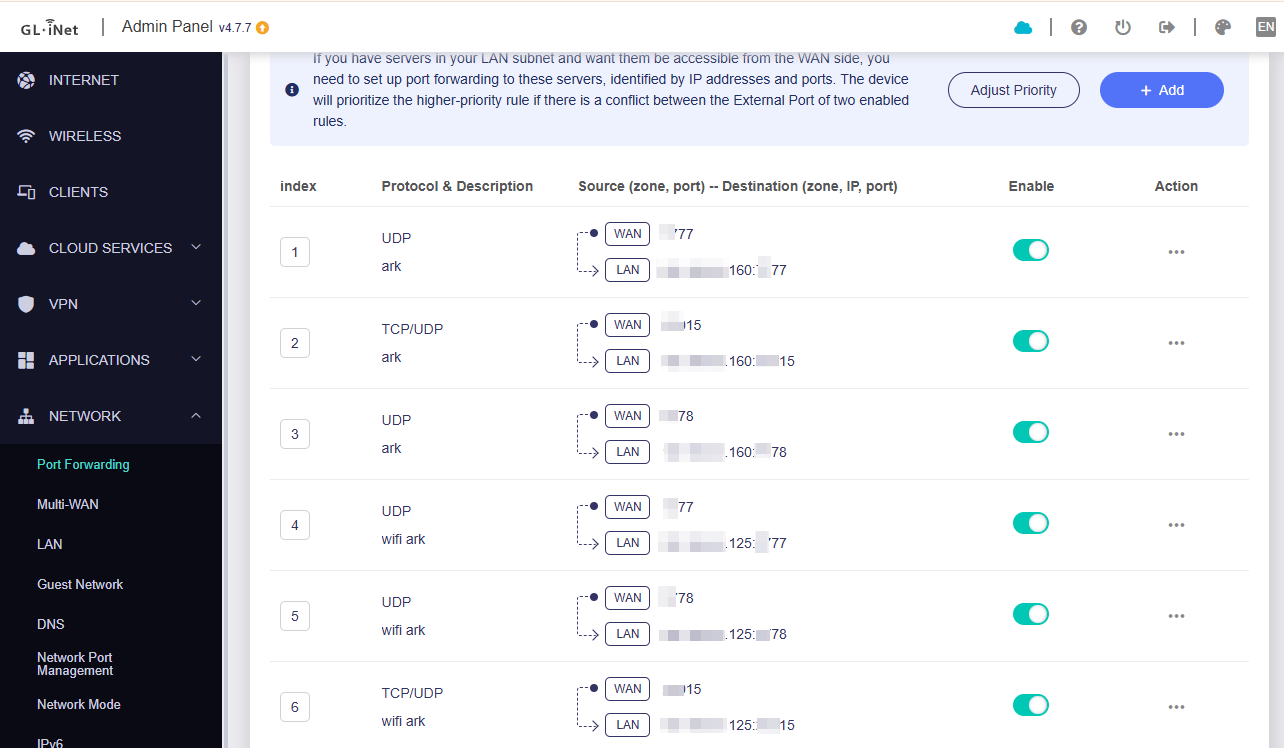

During a remote check, we noticed that your ARK dedicated server has both wired and wireless network adapters, and you’ve set up separate port forwarding rules for each connection type.
However, since a port of the WAN can only be mapped to a single LAN host, the router will only apply the forwarding rule with the higher priority—in this case, the one shown above.
We recommend that you:
  1. Connect your ARK dedicated server to the router using only one method (wired is recommended to avoid wireless interference) and remove any redundant port forwarding rules.
  2. Additionally, reserve an IP address for the ARK dedicated server to prevent the port forwarding rules from failing if its LAN IP changes in the future. A step-by-step guide is available here: Address Reservation Tutorial

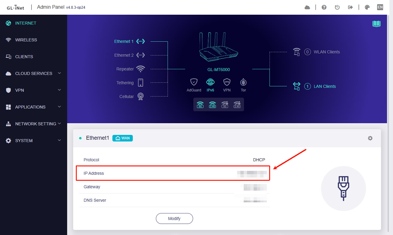

Afterwards, you can access your game server using your public IP address, as shown in Admin Panel → Internet → WAN.
