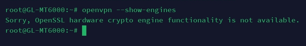

@blackbox I made the changes, but the application I use only works on weekdays. I will test it during the week.
The website below helped me too: Devcrypto Openssl on Openwrt - Unix & Linux Stack Exchange
Flint 2 OpenVPN speed is around 190Mbps maximum. Maybe the network throughput or the OpenVPN server is the limitation.
I’ve learned that the hardware engine doesn’t gain much performance boost.
Because it needs a driver and OpenVPN must do a context switch to handle packets. I fail to find the source link.
