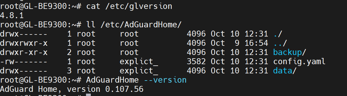

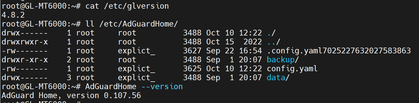

It seems we have been unable to reproduce this issue.
ADG Home functions normally on both devices and firmware versions you mentioned, and the relevant directories are present.
Flint 2:
Flint 3:

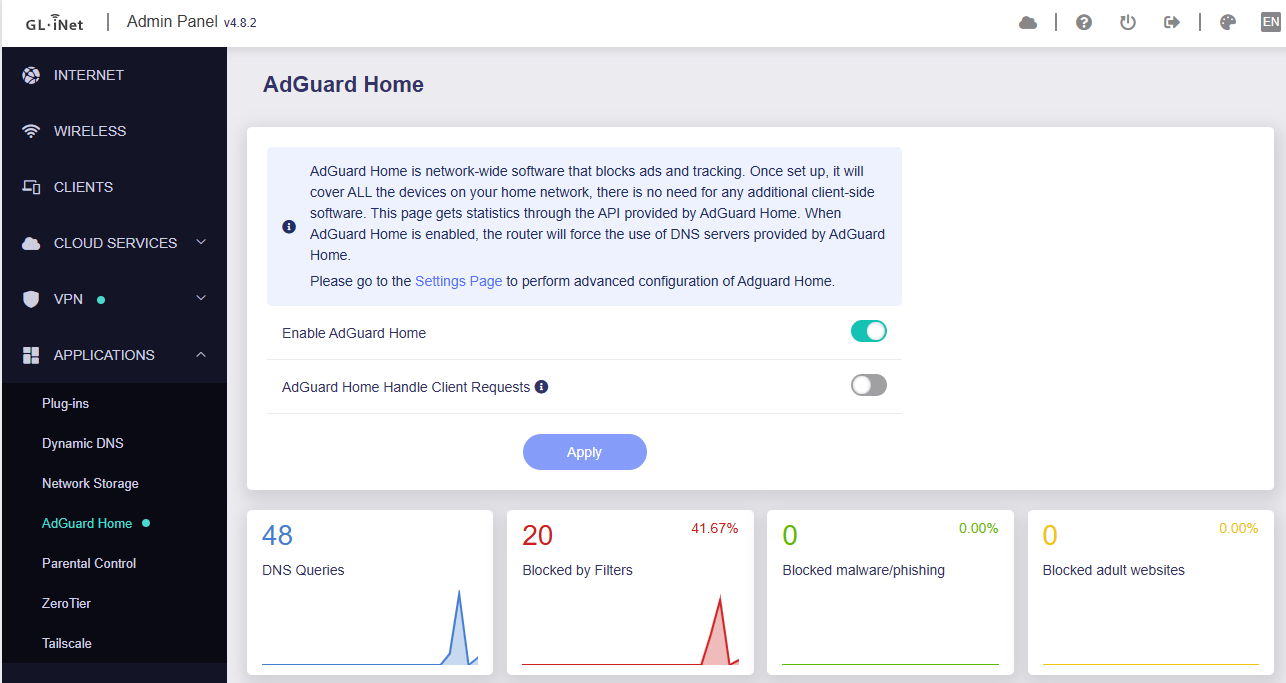

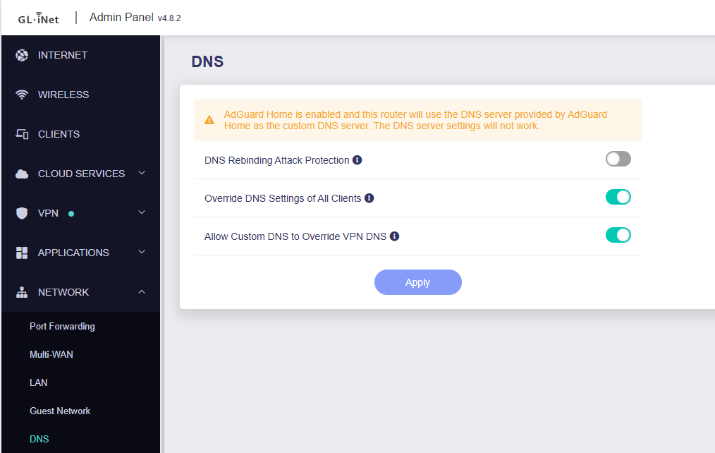

In the current version, if you need to run both ADG Home and the Policy VPN with domain list simultaneously, please ensure the “AdGuard Home Handle Client Requests” setting remains disabled.
Below is our tested configuration, verified to function correctly.

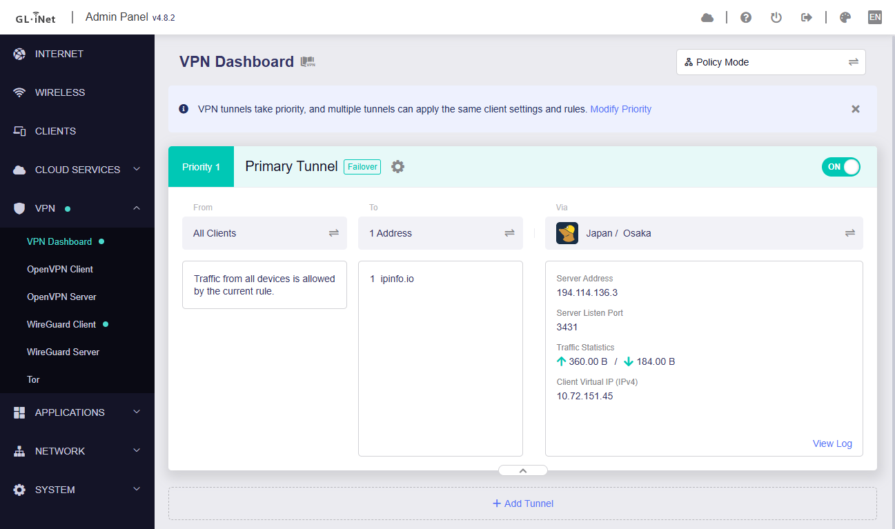

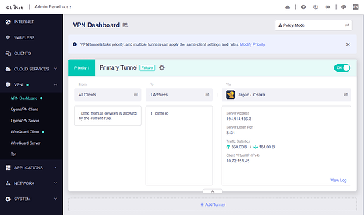

VPN Settings:
ADG Home Settings:
DNS Settings:
Test Result:
