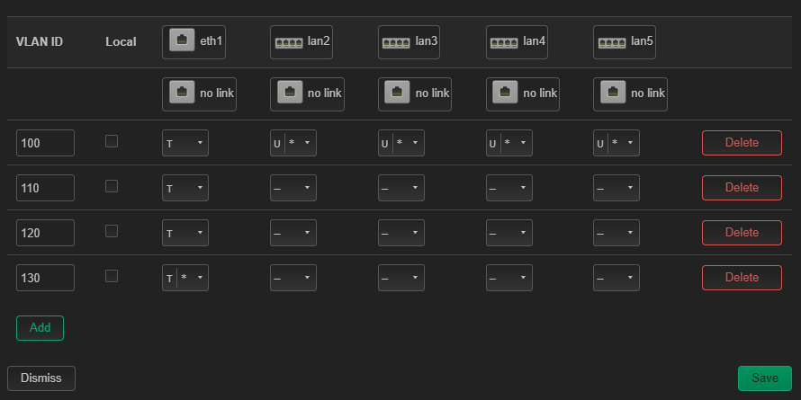

It's not active right now but I typically have for the physical ports:
I'm planning to try again in the following week. When I have this active again I'll get a brctl show and send it here.
