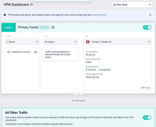

I have a Flint 2, and I am trying to setup a VPN tunnel for 1 device only which is an Apple TV.
Essentially when I enable it, the device cannot resolve domains. Seems like a DNS issue.

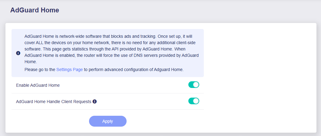

I’m using Adguard home. Tried disabling it, and same result. Tried “AdGuard Home Handle Client Requests” on and off and same result.

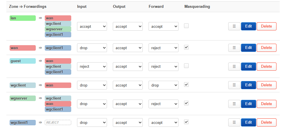

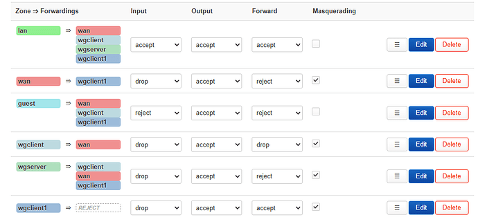

Only thing in noticed in LuCi firewall settings was wgclient1 is set to reject, but this might mean nothing. Same behaviour with OpenVPN anyway.

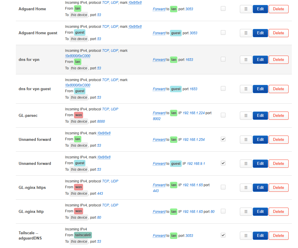

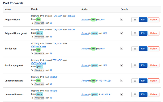

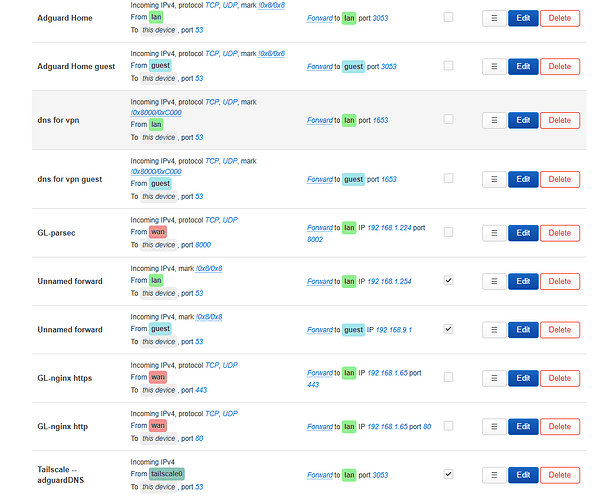

Not sure if port forward rules are relevant but just in case:

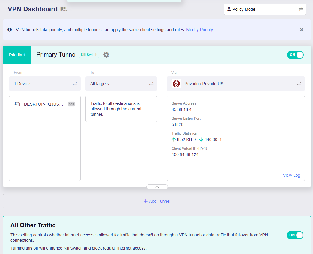

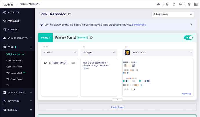

Please let us know your firmware version and provide screenshots of the following pages:
  • VPN – VPN Dashboard

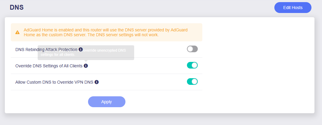

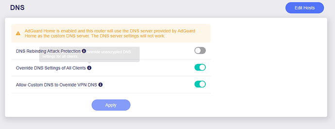

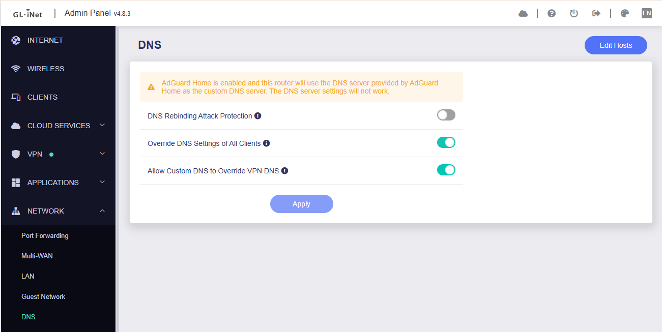

  • Network – DNS

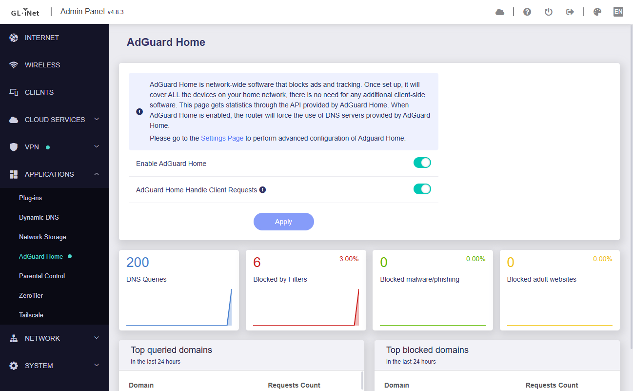

  • Application – AdGuard Home
We recommend doing the following:
  • Enable the VPN
  • In Application – AdGuard Home, enable AdGuard Home and “AdGuard Home Handle Client Requests”
  • In Network – DNS, enable “Override DNS Settings of All Clients” and “Allow Custom DNS to Override VPN DNS”
After applying these settings, check whether Apple TV still experiences DNS issues.

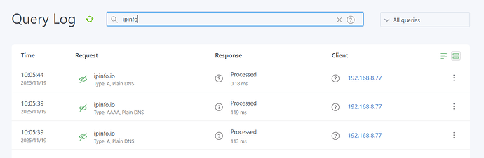

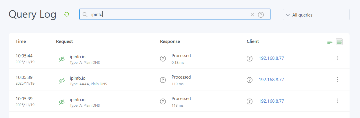

If the issue persists, please open the AdGuard Home management interface and review the Query Log to confirm whether Apple TV’s DNS requests are being processed correctly.

I’ve tried changing the settings as you have highlighted. Didn’t work.
I’ve checked the Adguard logs and appears no DNS requests are reaching Adguard when VPN tunnel is on from any client.
I have previously disabled Adguard completely and it made no difference.

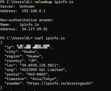

Thanks Will, definitely a DNS issue, as i tried nslookup as well and fails on DNS.

The DNS does look unusual. Its Privado VPN –> DNS = 198.18.0.1,198.18.0.2
Think i fixed it.
The two Adguard rules were not active. Once enabled them - all seems fine!
