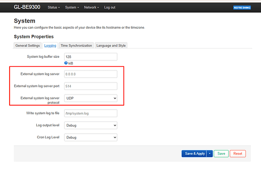

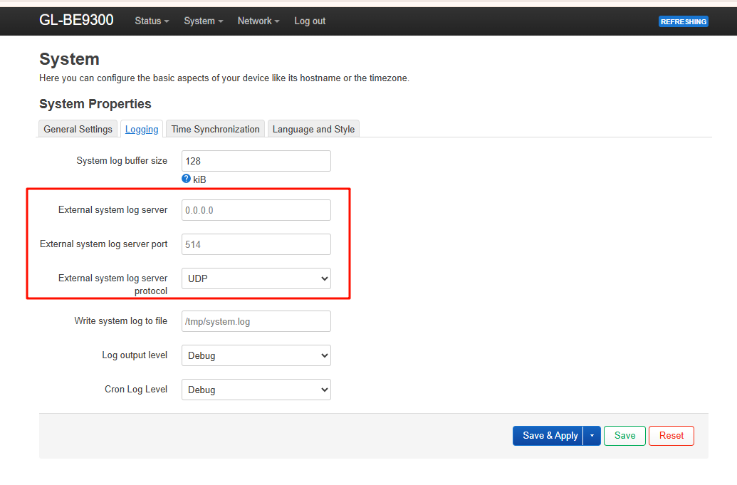

If no crash logs are found, you may need to configure remote logging to a UDP server running on another device, via using Luci - System - System - Logging.
