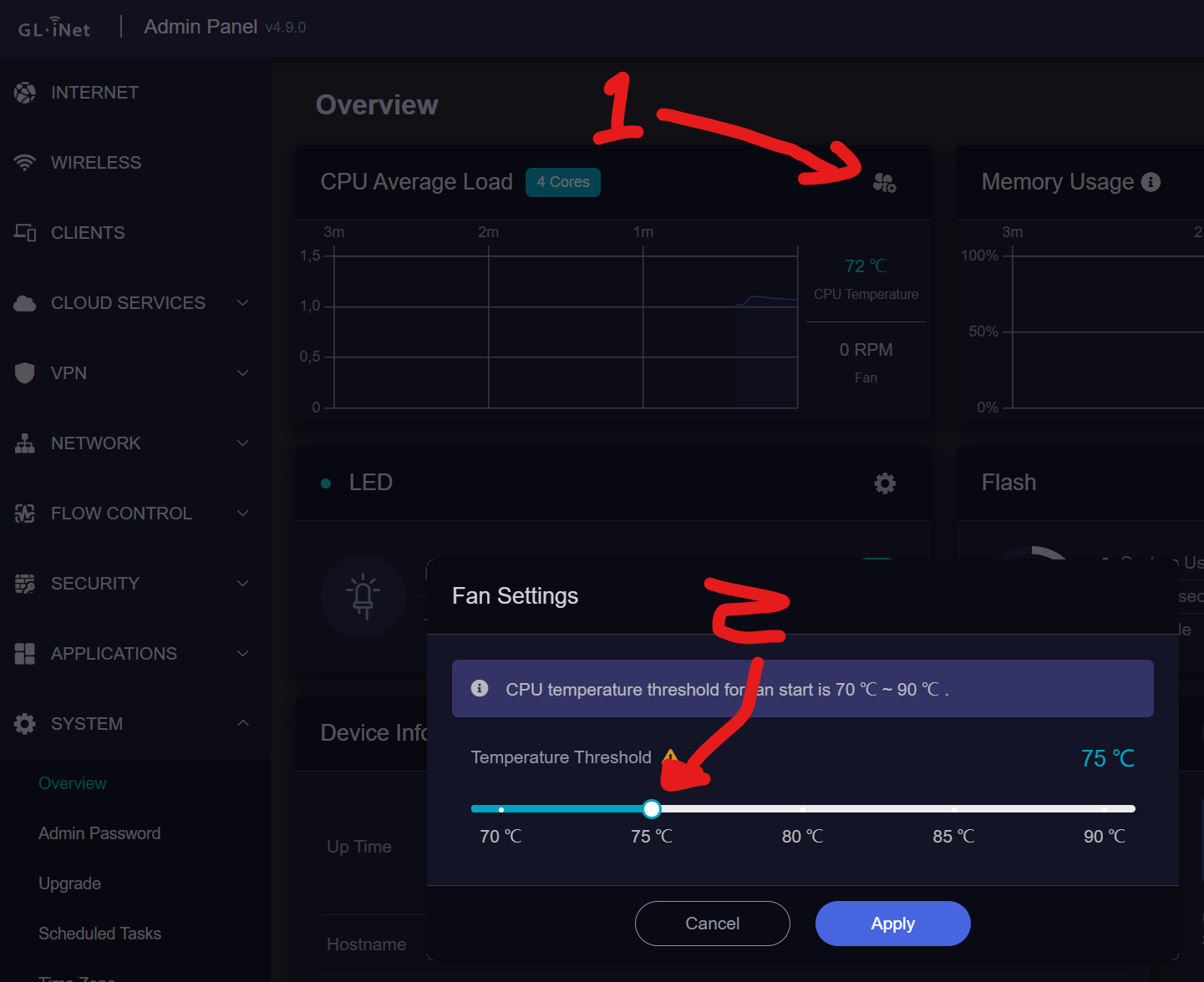

My Flint 3 is running at about 70 degrees C and the fan is not running. I understand that this is normal. I would like the fan to start at a much lower temperature; eg 55 deg C
Is there a commend to set the fan starting temperature?
If I cannot set the fan starting temperature, can I turn the fan on always at a set speed?
Thanks
@harrisc
In GUI go to “Overview” section, than on “CPU Average Load” click on the Fan icon, adjust the slider with the temp threshold you wish for the fan to kick in.
Thanks
It was set at 75 degrees. I have set it at the lowest which is 70 degrees, but I would like to set it lower if possible! Any suggestions?
I use 2 fans, slow spinning, to cool the flint and they keep the router at a max temp of 46 degrees at a room temp of 27.
I am currently using an external fan to keep the router cooler. While this works I thought that the internal fan may be more efficient.
I think one may be able to control the fan t} start at a lower temperature by use of SSH commands. If anyone knows appropriate commands, please let me know

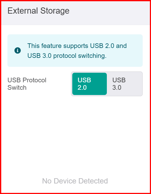

I am experimenting with failover on the Flint 3 on the 4.10.0 beta and trying to use a mobile broadband LTE USB stick.
It is a Huawei E3372 connected to the USB port (of course) but I see in Overview page/ external storage no device is detected. While that says "External Storage" Should I see the USB stick recognised there (Changing the port to USB 3.0 makes no difference)?

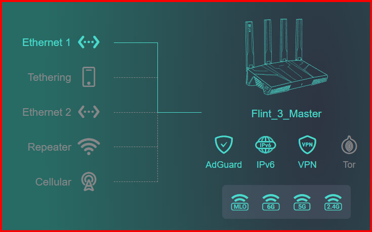

I also do not see any alternative connection for the internet on the Internet page.
So does that mean the USB stick I am using is not compatible with the FLINT 3? I guess it does?
Is there a setting somewhere I am missing?

The corresponding commands are:
uci set glfan.globals.temperature=60
uci commit
/etc/init.d/gl_fan restart
Please note that we do not recommend doing this. The minimum fan temperature threshold of 70°C already provides a good balance.
Lowering the threshold further may cause the fan to run more frequently and could potentially reduce its lifespan.
You can find the list of compatible LTE USB sticks here:
There are many variants of the Huawei E3372, so please make sure the one you purchase is included in the supported list. Also, some variants may only work properly with certain firmware versions:
No, the LTE USB stick connection status will not be displayed here.
You may try switching the Huawei E3372 to HiLink mode and test again. It should then be detected as Tethering.
Thanks for the link that is just what I needed and after reading the doco I see the step I was missing was to boot/reboot with the USB stick connected, then I could see it as "Tethering".

These commands worked and the fan is running at a lower temperature
More on Tethering....
I have the Huawei E3372h-607 stick and it is detected as tethering and I can connect to it.
When connected as i said in an above post, the stick has the default IP of 192.168.8.1 with a massage advising of an IP conflict and to change Subnet IP.
I changed the router IP to 192.168.7.1 and now tethering works but I do not want to want to have to change the router's default IP (naturally).
So is the only solution to change the IP of the Huawei E3372h-607 stick?
I found a Github solution to that, but have not applied that preferring a different solution if available. And I do not know if I change the stick IP whether or not the IP sticks after a reboot or firmware reset....
Yes, an IP address/subnet conflict can only be resolved by changing the IP address/subnet of one of the devices.
