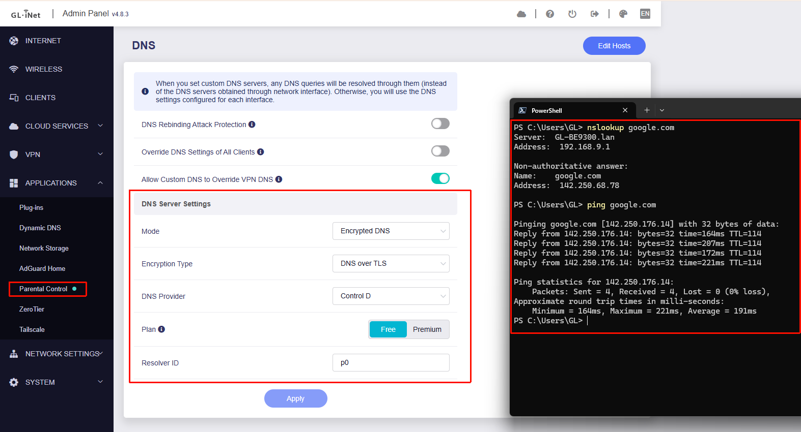

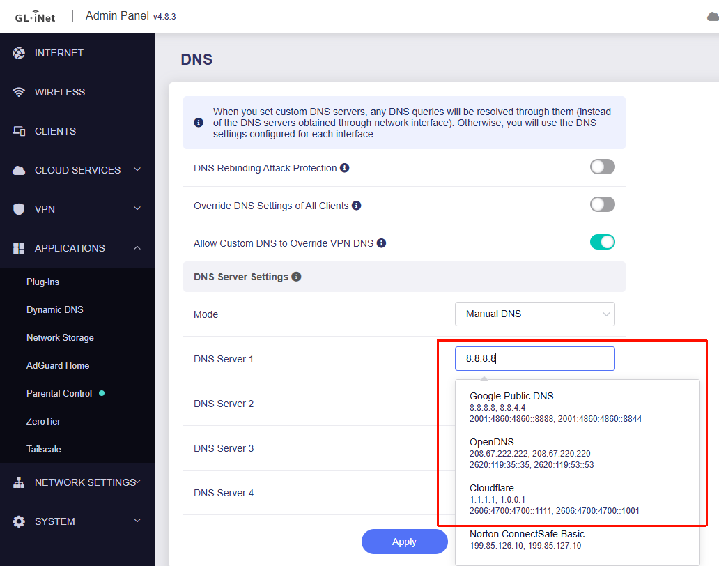

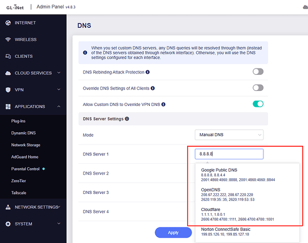

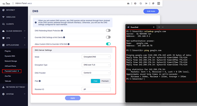

We have conducted testing locally using a Flint 3 running firmware version v4.8.3 , but we were unable to reproduce the issue. Devices on the Guest Wi-Fi are able to resolve DNS addresses and access the internet normally.
If you switch from Control D to Google DNS or Cloudflare DNS, do the devices on the Guest Wi-Fi function correctly?
