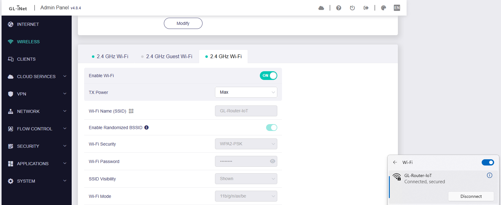

Added the wifi-iface as suggested. It does show up in the list of available APs when scanning, but association to the AP fails for some reason. This is now on a remote location and testing isn’t easy, but luckily I have access to another OpenWrt host and a Raspberry pi connected over ethernet which allow me to scan and test associations. Just tested connecting with `iwd` from the raspberry – it fails consistently.
This is a bit unusual—it’s working normally on our end.
Could you share the contents of /etc/config/wireless so we can take a look?
Please make sure to redact any sensitive information such as MAC addresses and passwords.
Alternatively, you can follow the guide below to share your device with us via GoodCloud for remote troubleshooting.
