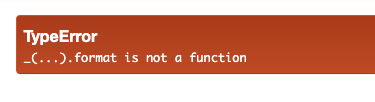

I got a GLiNet router to be able to setup VLAN, Now I learn there’s no GUI for that,
I need to go into LUCI,
Almost every page don’t load and show this red error instead.

I just got a brand new Flint 3 and i get this exact error when i go to most menus in Luci > Network.
I mainly want to setup ipv6 firewall.. which you cannot do with this error.
I have not installed anything or setup anything apart from the first setup screen after installing each firmware with all settings cleared.
As soon as i do the basic setup screen - i go to advanced > install Luci
GL-BE9300 Flint 3
I have tried 4.8.1, 4.7.14, 4.8.2
All of these show the same error - all with only the basic setup screen done.

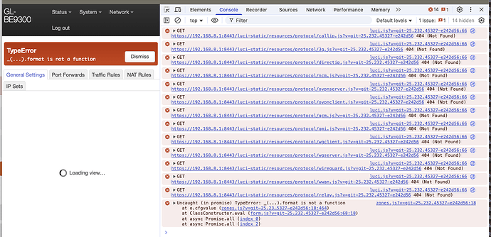

I worked it out - looks like its only an issue with brave browser.
works in chrome

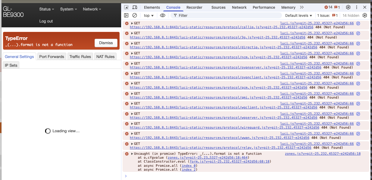

I still get the error on Chrome at https://192.168.8.1:8443/cgi-bin/luci/admin/network/firewall/zones
I tried in Firefox, It works! Still my Chrome is pretty fresh with no addons.
Does Chrome have any ad-blocking or script-management extensions installed? If using Incognito/Private browsing mode without these enabled, does Luci function properly?
