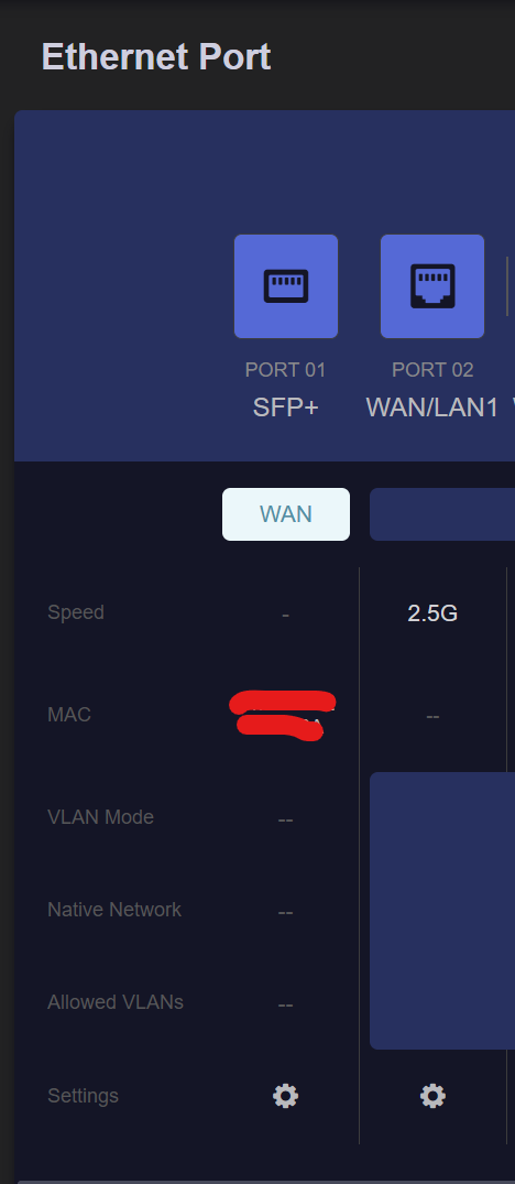

Possibly related: the Ethernet Port page shows WAN/LAN1 as link down while it is connected and working — same as this thread. If switch link-state reporting is unreliable in general, these might be one issue rather than two.

I don’t get any stats for it on the ‘Ethernet’ page in the router GUI either. Just the MAC address.

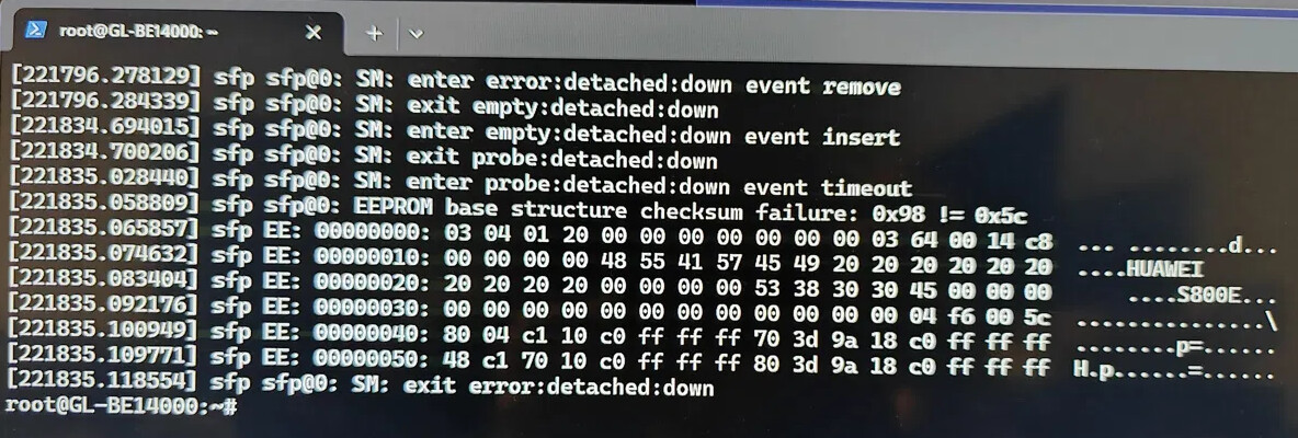

Hi, Same / Similar issue. I created a separate topic as it likely effects every ViewQwest customer in Singapore. (That one is more AI Slop, this one is hand-written :stuck_out_tongue:)
In my case the SFP module has a checksum failure:
A override would be super useful. I have an intel x520 nic, and they have the option within the ixgbe driver ‘allow_unsupported_sfp’ that would log the failure and then continue.
Not a seating issue, SFP module verified good on the network (Currently connected through the same module through the aforementioned x520 nic and virtualised pf-sense).
Happy to assist with testing if required (time permitting)
