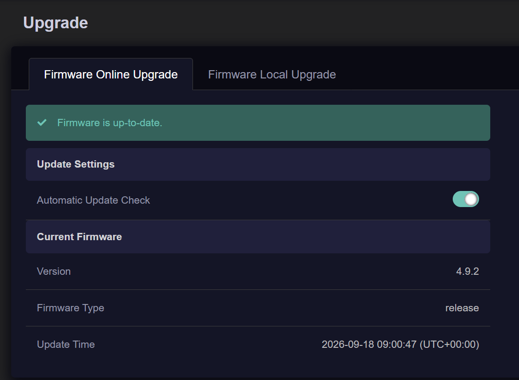

I don’t have the ‘Accept Preview Plan’ option available.
That confirms the Accept Preview Plan control is not exposed on your Flint 4’s current firmware, so there is nothing you can enable from that page. The earlier instruction about enabling the switch does not apply to this build.
To install beta 3, download the official GL-BE14000 image from the GL.iNet Download Center and use System → Upgrade → Local Upgrade. Given the upgrade and configuration-retention reports in this thread, keep the LuCI backup but also record your DHCP reservations separately; restoring a 4.9.2 backup onto 4.11 may introduce incompatible settings.

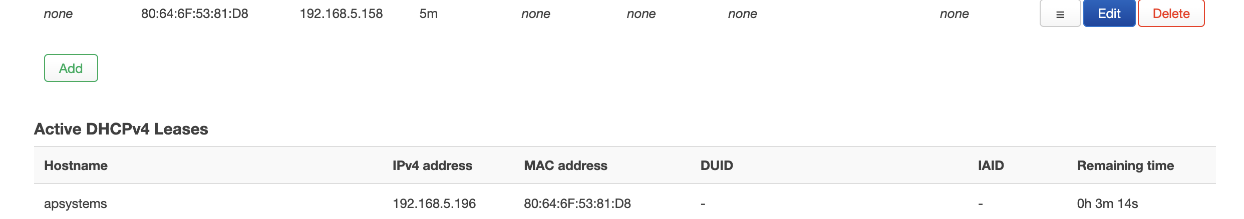

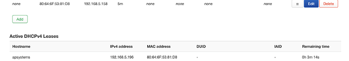

I have the Flint4 with 2 VLANS. 1 and 15 for IOT but I can not manual change the IP Adress to fixed IP adress for the VLAN15 the DHCP is only able to change the VLAN1 DHCP settings. Is there a way to change this behavior ?
The GL.iNet Admin Panel currently supports address reservations only for the Main Network, not the IoT or other VLAN networks. For VLAN 15, configure the reservation through System → Advanced Settings → LuCI → Network → DHCP and DNS → Static Leases.
Add the device’s MAC address and an IPv4 address belonging to the VLAN 15 subnet, preferably outside its dynamic DHCP pool, then select Save & Apply. Reconnect the device or renew its DHCP lease afterward. If the device uses a randomized/private MAC address, disable that feature for this network or reserve the randomized MAC actually shown by the router.
This does not work it still uses diffrent ips. this way the vlan feature is not usable
A static lease should work on VLAN 15 through LuCI, so receiving a different address means either the reservation does not match the client’s active MAC address or the firmware is not applying it correctly. Please first confirm that the MAC shown for the connected VLAN 15 client exactly matches the reserved MAC; phones and computers may use a private/randomized MAC per network. Then disconnect the client, delete its existing lease or reboot it, and reconnect so it performs a new DHCP request.
If it still receives another address, please provide the exact firmware version/build and a redacted screenshot of that single LuCI static-lease entry. Do not post the full DHCP configuration or other clients’ MAC addresses. This will determine whether the entry is malformed or whether this is a firmware-specific DHCP issue rather than expected VLAN behavior.
I tried also the newes beta. Version4.11.0 beta3
Mac adress is correct i can also chose this from the drop down menu, i changed the lease time to 5 min and this worked but the ip adress is random assigned
Since beta 3 honors the five-minute lease time but ignores the reserved address despite the correct MAC, this is not expected DHCP behavior. The next check is whether LuCI saved the VLAN association for that static lease.
If this was the most recently created static lease, run the following by SSH and share the output after redacting most of the MAC address:
uci show dhcp.@host[-1]
Also state the logical interface name shown for VLAN 15 under LuCI → Network → Interfaces. If the host entry lacks an option network association, it can be bound explicitly to that interface; if the association and reserved IP are already correct, this points to a firmware-specific DHCP issue in 4.11 beta 3 rather than another client-side lease problem.
dhcp.cfg29fe63=host
dhcp.cfg29fe63.mac='80:64:6F:53:81:D8'
dhcp.cfg29fe63.ip='192.168.5.158'
dhcp.cfg29fe63.leasetime='5m'
interface name iot. interface br-iot
The lease entry is missing its VLAN/network association. Bind it to the logical iot interface, then restart DHCP:
uci set dhcp.cfg29fe63.network='iot'
uci commit dhcp
/etc/init.d/dnsmasq restart
Ensure 192.168.5.158 belongs to the IoT subnet and is not already in use, then disconnect and reconnect the client to force a new DHCP request. If it still receives another address, share the new address and the output of uci show dhcp.cfg29fe63; that would indicate beta 3 is ignoring a correctly bound reservation. Please also edit the earlier post to redact most of the publicly displayed MAC address.
