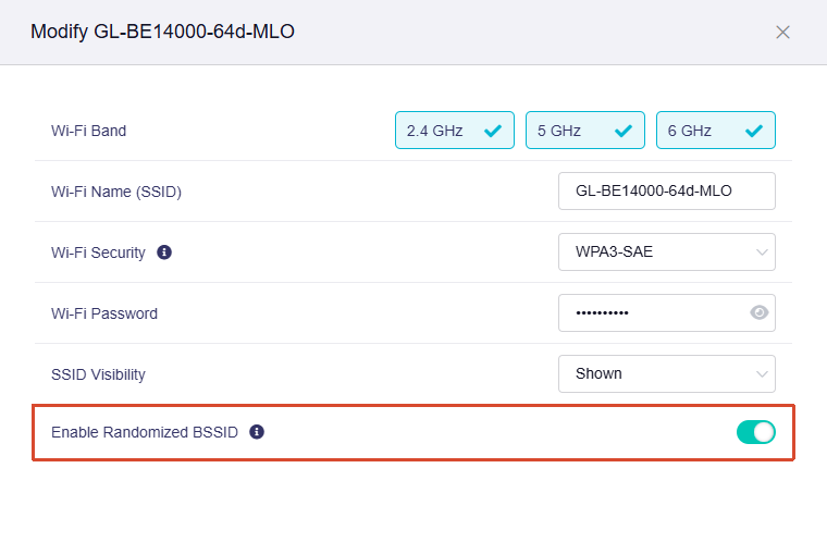

can you try disabling randomised BSSID?

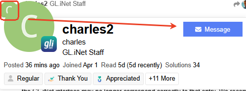

If the issue can be reproduced again, please export the system log and send it to us via private message.

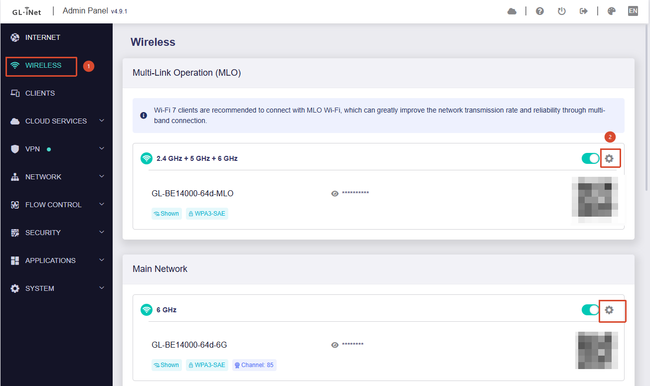

Where do I do set this? I need the correct syntax for this and which file I have to edit. Within LuCI i can only change SSID.

In the Admin Panel, navigate to Wireless, as illustrated below:

The BSSID approach I will test tomorrow.

In the meantime, you can also try disabling Randomized BSSID and see whether it makes any difference to the reconnection behavior.

I tested on weekend disabling random BSSID. I didn’t change the outcome.
