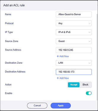

I've tried to forward the guest device to the server in Luci which didn't work. I also tried to do this via Security - > ACL and it still didn't work.

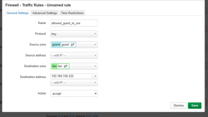

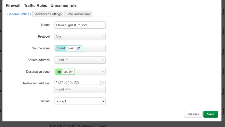

I’d suggest adding a firewall rule in LuCI to allow guest network devices to access specific devices on your main network. That should be the smallest change needed to meet your needs. You can refer to the screenshot below.

Alternatively, you can try configuring this through Security → ACL → Add Rule in the GL.iNet Web Admin Panel.
Since you mentioned that you have already tried ACL. If the issue persists after trying the settings above, could you please share screenshots of your ACL rule and firewall zone settings so we can investigate further?
And could you please try pinging the server's LAN IP address from the specified Guest device to check whether it is reachable?
