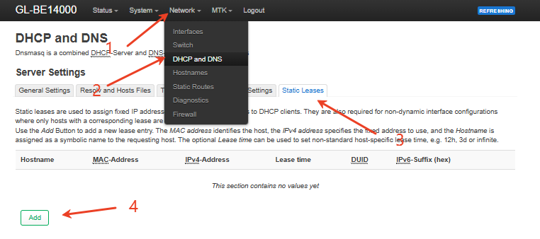

You can do it from LuCI - Network → DHCP and DNS → Static leases
Or via SSH
uci add dhcp host
uci set dhcp.@host[-1].name="$name"
uci set dhcp.@host[-1].mac="$mac"
uci set dhcp.@host[-1].ip="$ip"
uci set dhcp.@host[-1].network="$network"
uci commit dhcp
/etc/init.d/dnsmasq reload

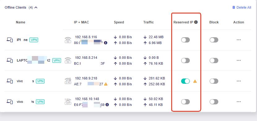

You can configure the address reservation directly from Clients → Reserved IP, as shown in the screenshot below.
After enabling it, you may see a yellow warning triangle next to the Reserved IP switch.
This is currently a UI display issue and does not affect the reservation itself — the configuration is still applied correctly.
Thanks, the option to set this in the subnets page is better as we can choose which IP to allocate to the device from the router.

If you would like to manually specify which IP address should be assigned to a particular device, you can currently configure it through LuCI → Network → DHCP and DNS → Static Leases .
