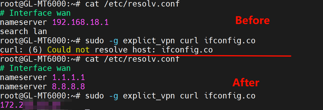

I have a flint 2 v4.8.3 and were successful setting up a wireguard client. I can specify clients and clients traffic routes through the VPN just fine. I can also sudo -g explict_vpn ping 1.1.1.1 and get responses. However sudo -g explict_vpn curl ``ifconfig.co gives cannot resolve host. I can only resolve with Network→DNS→DNS Server Settings as encrpyted DNS, either TLS or HTTPS works fine; anything else cant resolve any host using explicit_vpn. Any pointers appreciated!

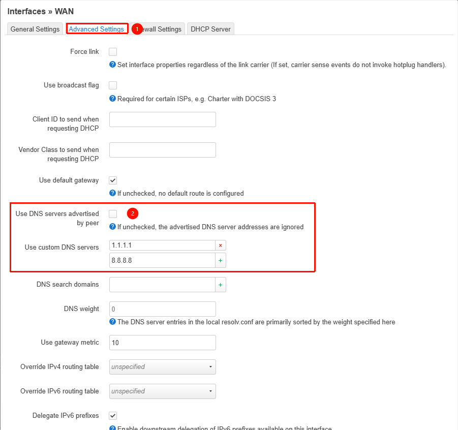

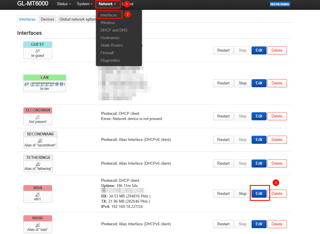

If our understanding is correct, you can resolve this by manually adjusting the DNS settings of the WAN interface. The steps are as follows:
  1. Go to LuCI → Network → Interfaces and edit the corresponding WAN interface
  2. Set its DNS to a server that is reachable via the VPN network
After that, the sudo -g explicit_vpn command should work normally.
perfect thank you. the WAN DNS was somehow set to my ISP’s in /etc/resolv.conf and now it seems to work as expected after forcing the WAN DNS to a public one.
