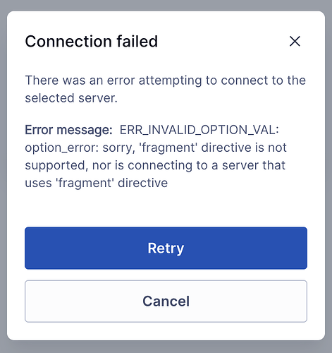

if I add fragment in ovpn file it gives below error when I try to connect VPN:
The OpenVPN Connect v3.x client does not support the fragment parameter.
Please try using the open-source OpenVPN v2.x client instead:
